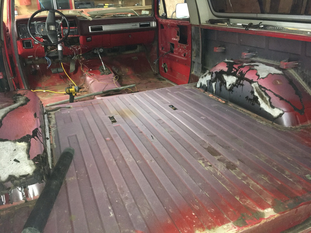

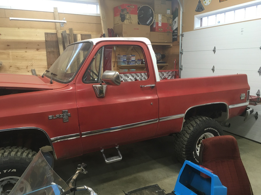

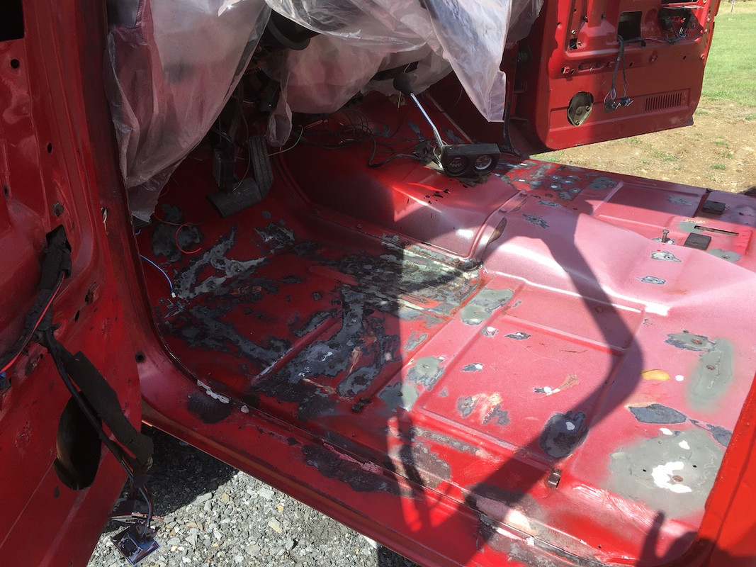

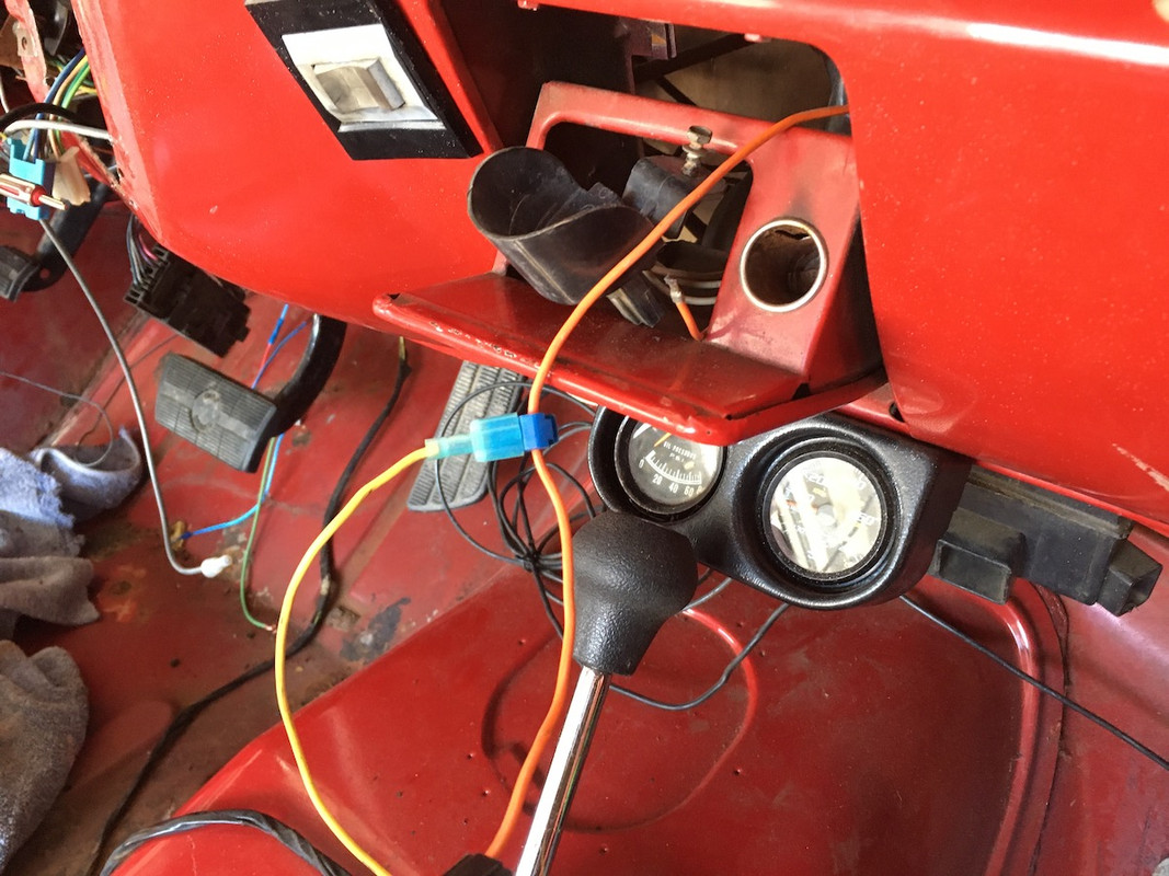

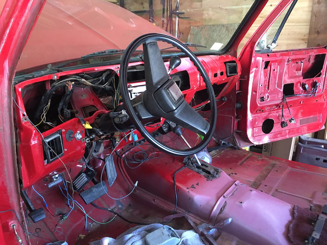

Thought I'd post an update on the interior of my K5. Nothing too exciting yet...but plugging away.

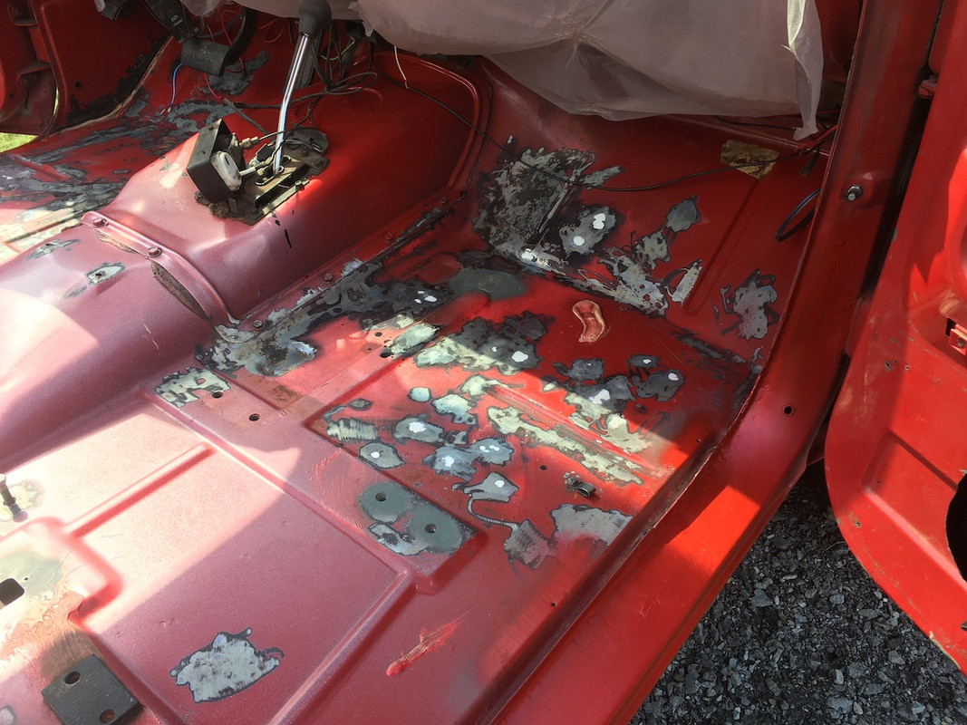

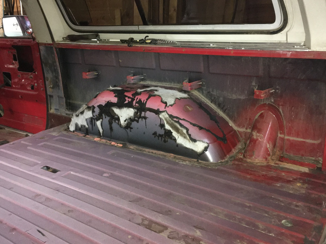

I did have some success getting the adhesive off of the wheel wells. The Whizzy Wheel didn't work. In the end, I just took my time and used a heat gun and a metal scraper. The plastic ones just didn't work so I used a metal scrapper. I nicked the paint here and there so just touch up everything with some primer. Took about an hour per side.

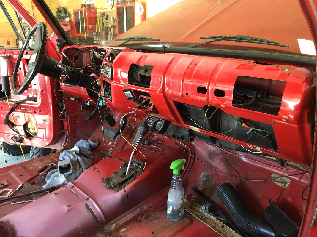

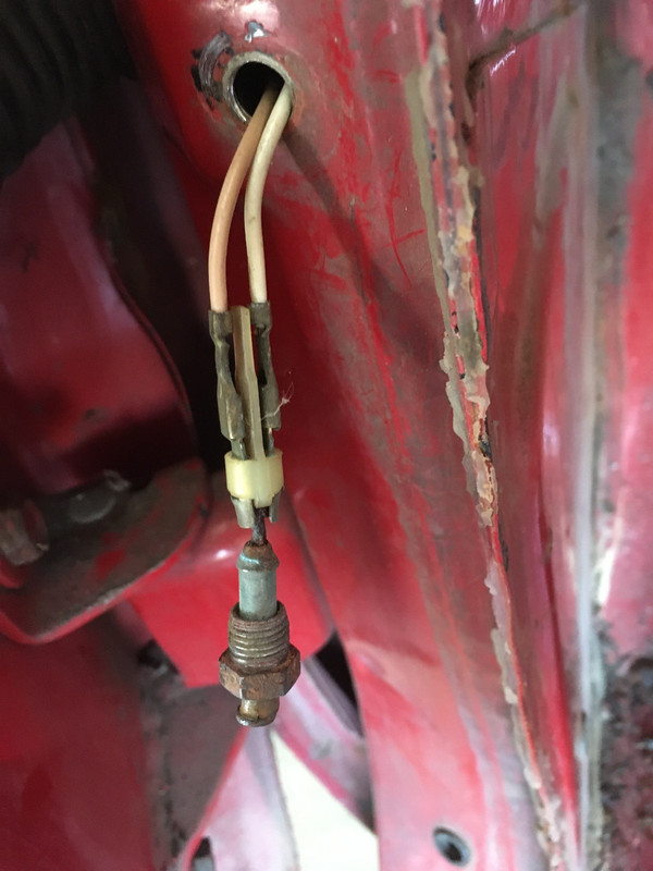

I then tore into the dash in preparation for a new stereo and speakers. The previous owner cut the wires running to the dome lights for some reason? And the wires to the under dash courtesy light were severed. So, I've got some trouble shooting to do there.
I need to replace the courtesy light switches while I'm at it. My '84 isn't suppose to have this style of switch...so not sure what's up with that.

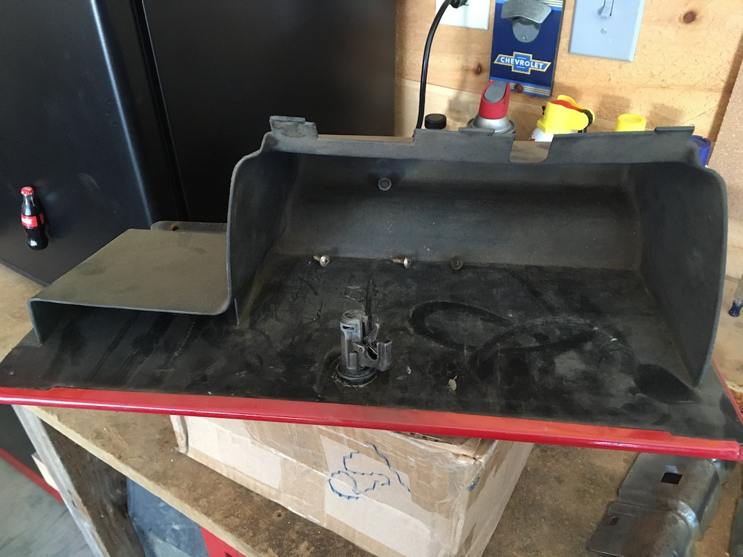

Removed the glove box to swap out the latch and found no options list. Kind of a bummer. Bought a radio patch panel off a member here on the forum. Getting that ready to weld in. And I installed a set heavy duty power windows relays from LMC. Made a huge difference.

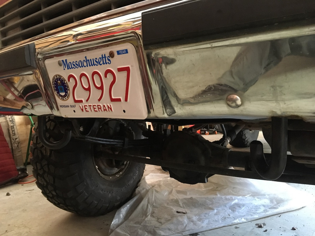

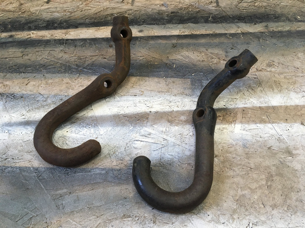

Found a set of factory tow hooks on Facebook for $20...got them primed and painted and installed. Wasn't sure if the hooks face in or out? I mounted them facing in.

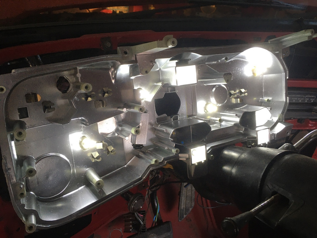

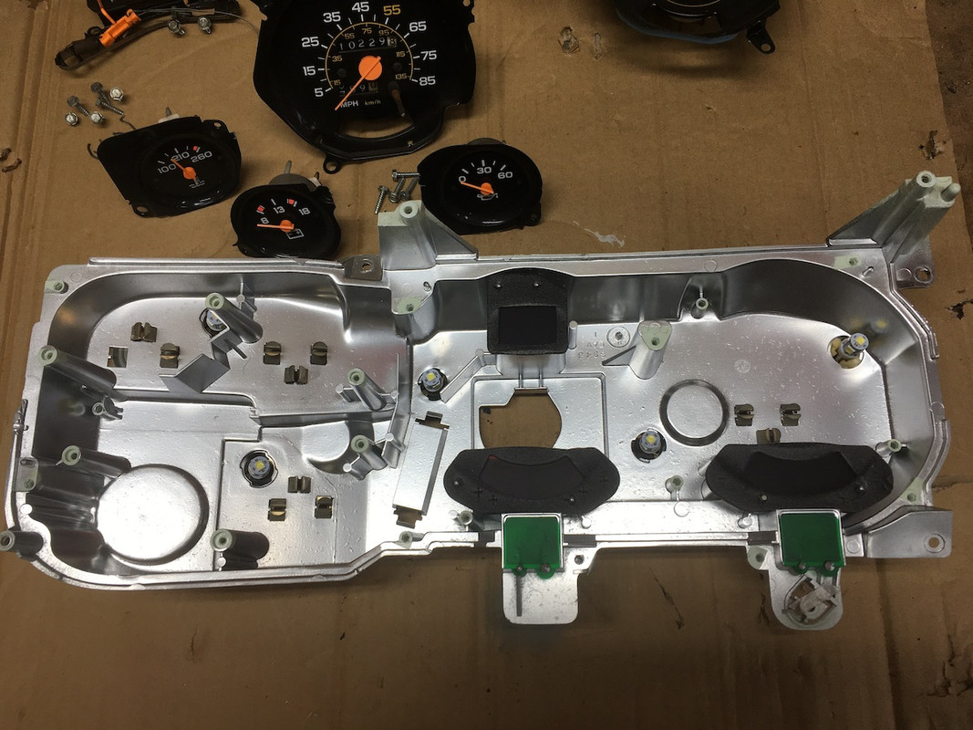

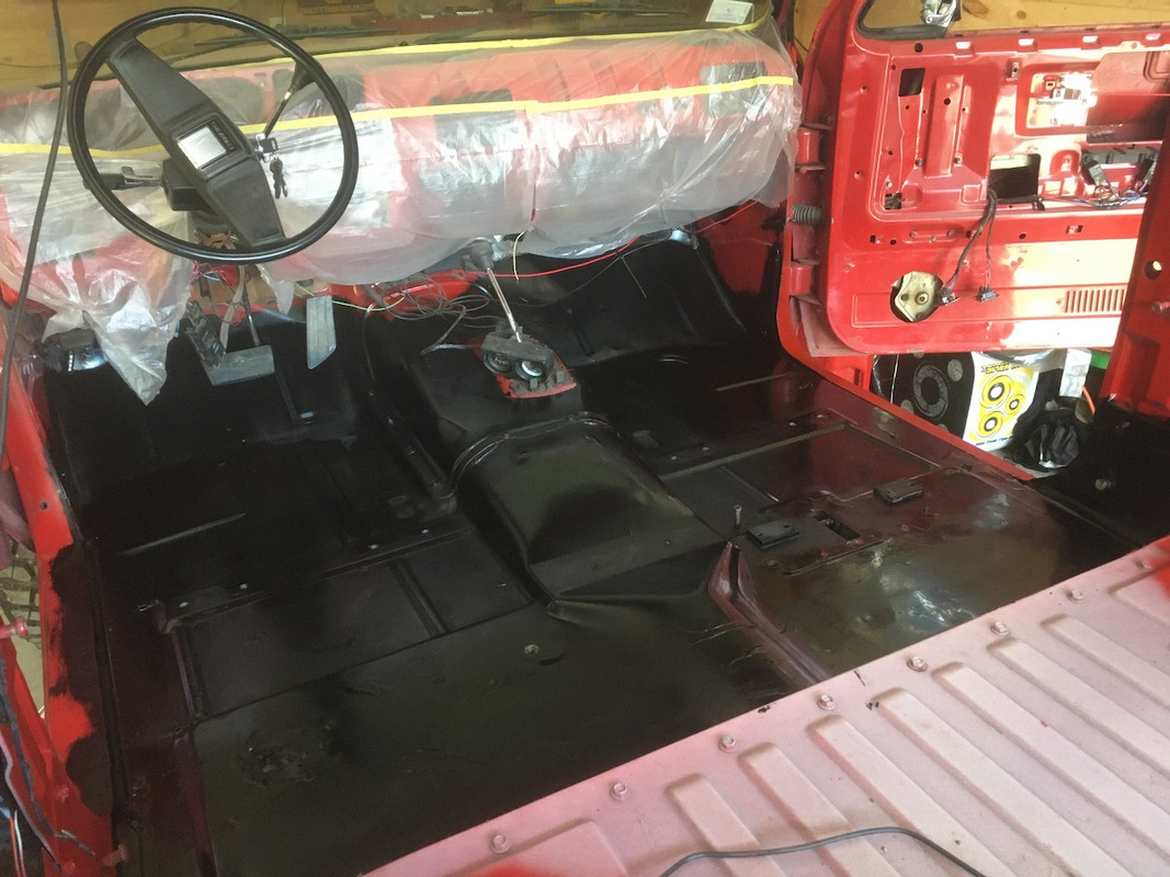

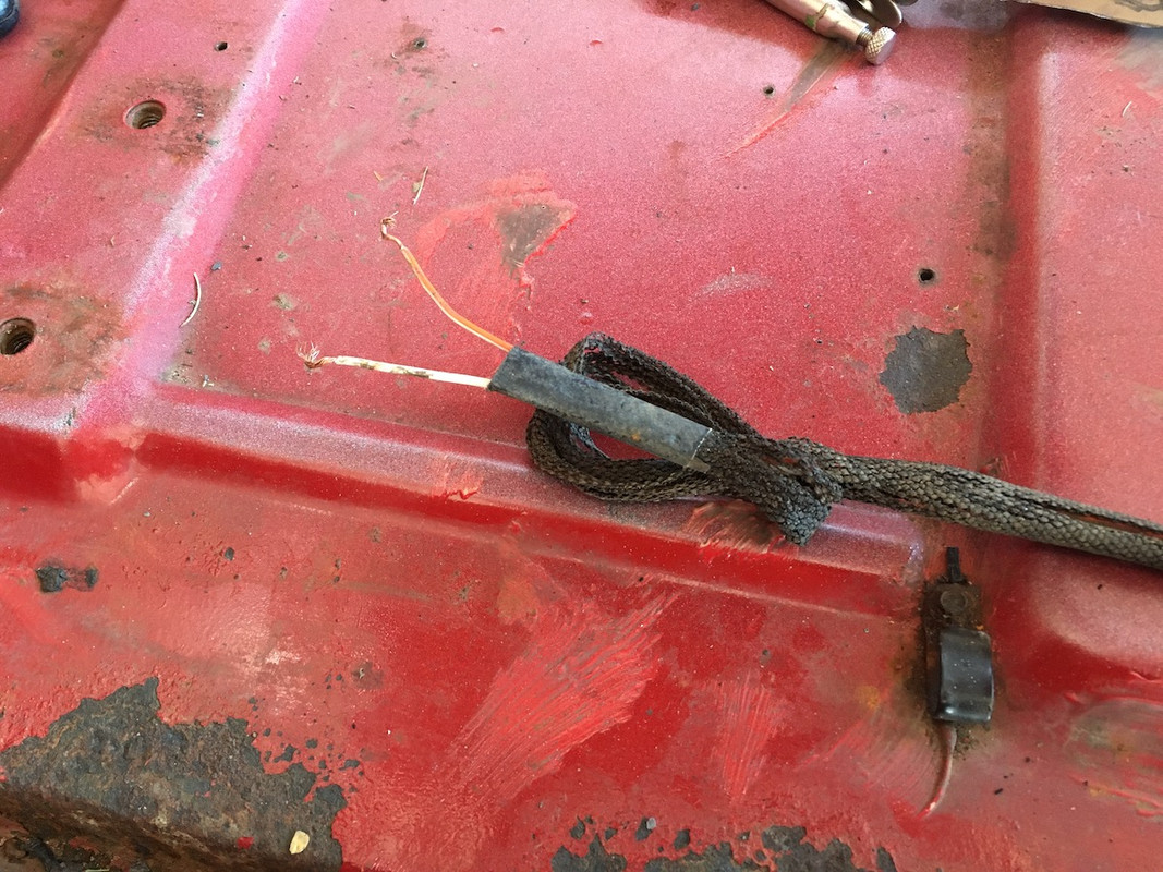

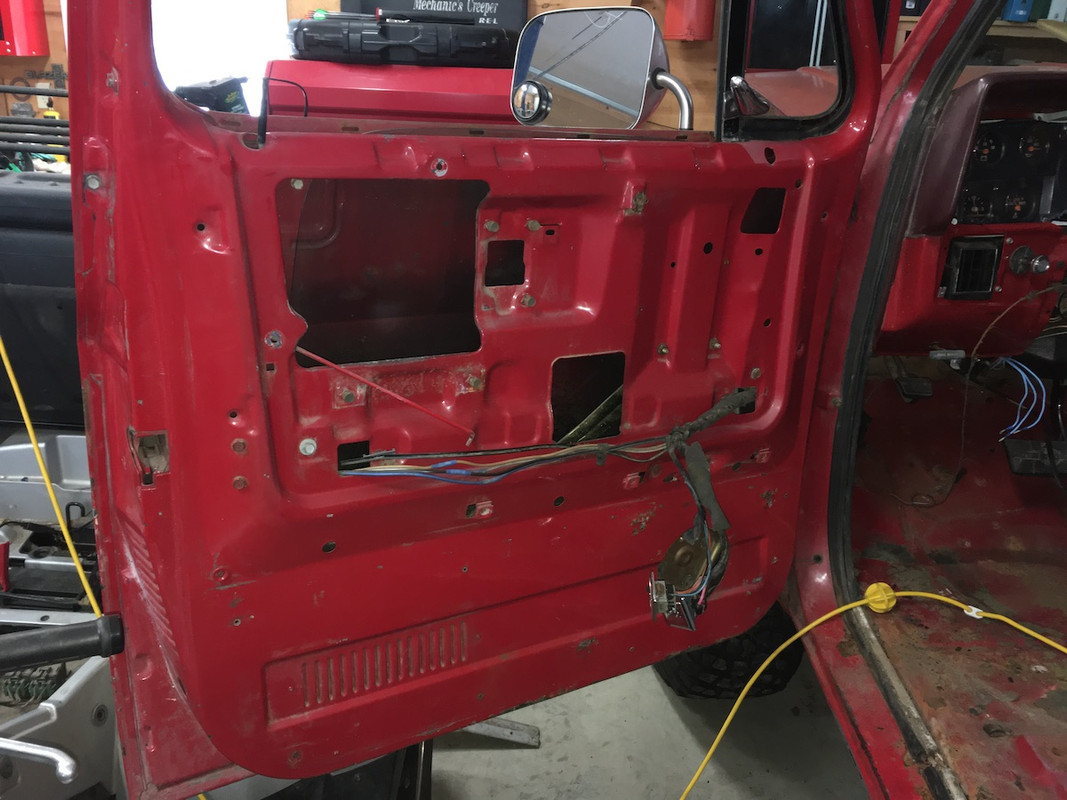

Thought I'd do an update. Been working in some wiring issues, getting interior plastic trim cleaned and painted, small details....but mostly taking care of rust issues and prepping the floor for POR 15.

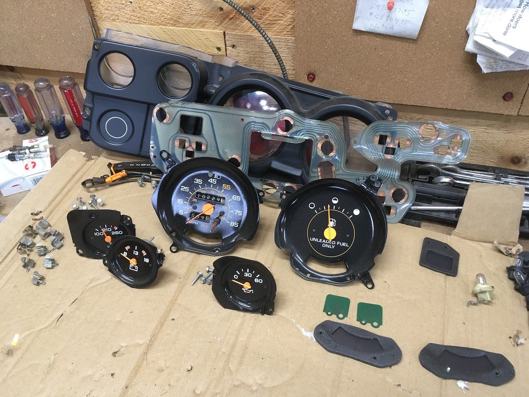

First...did a refurbish on the gauge cluster...cleaned it and did a metallic silver paint job and all new LED lights. Pretty sure it made the cluster brighter at night.

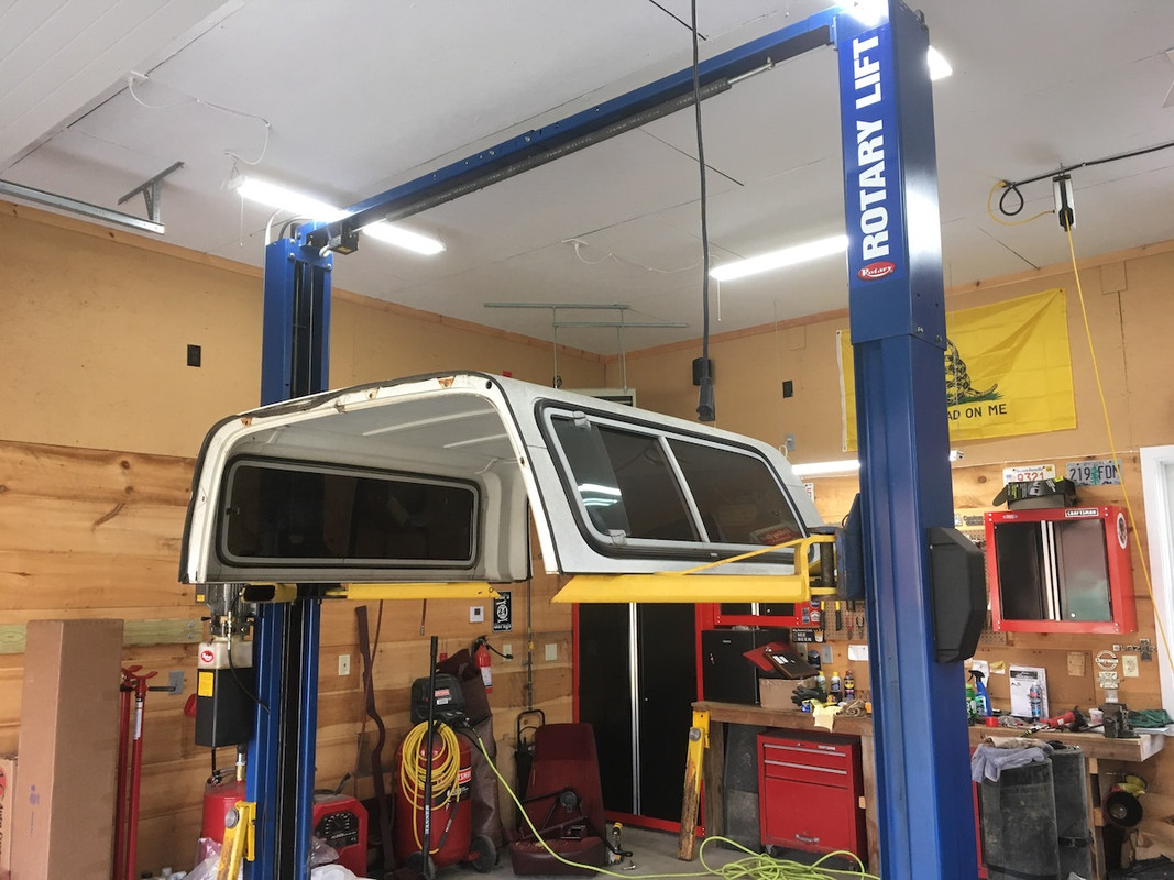

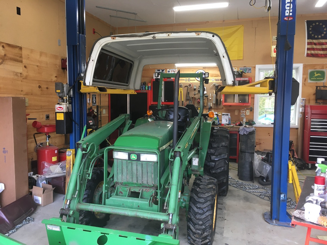

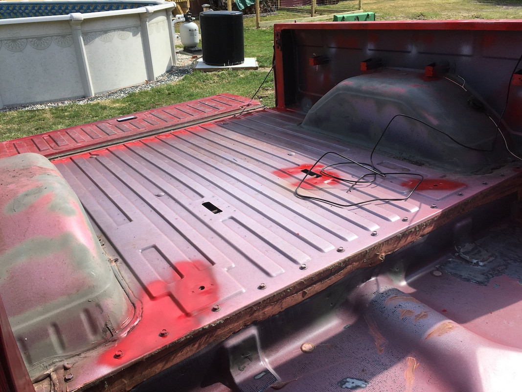

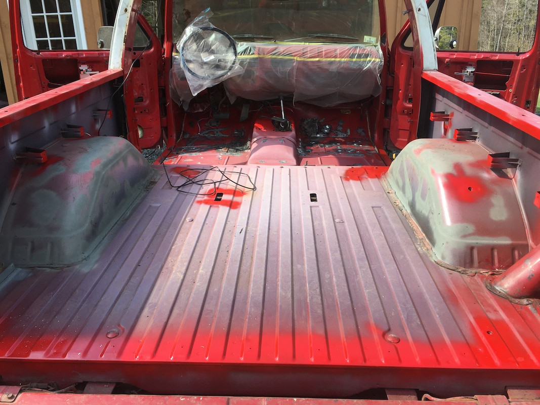

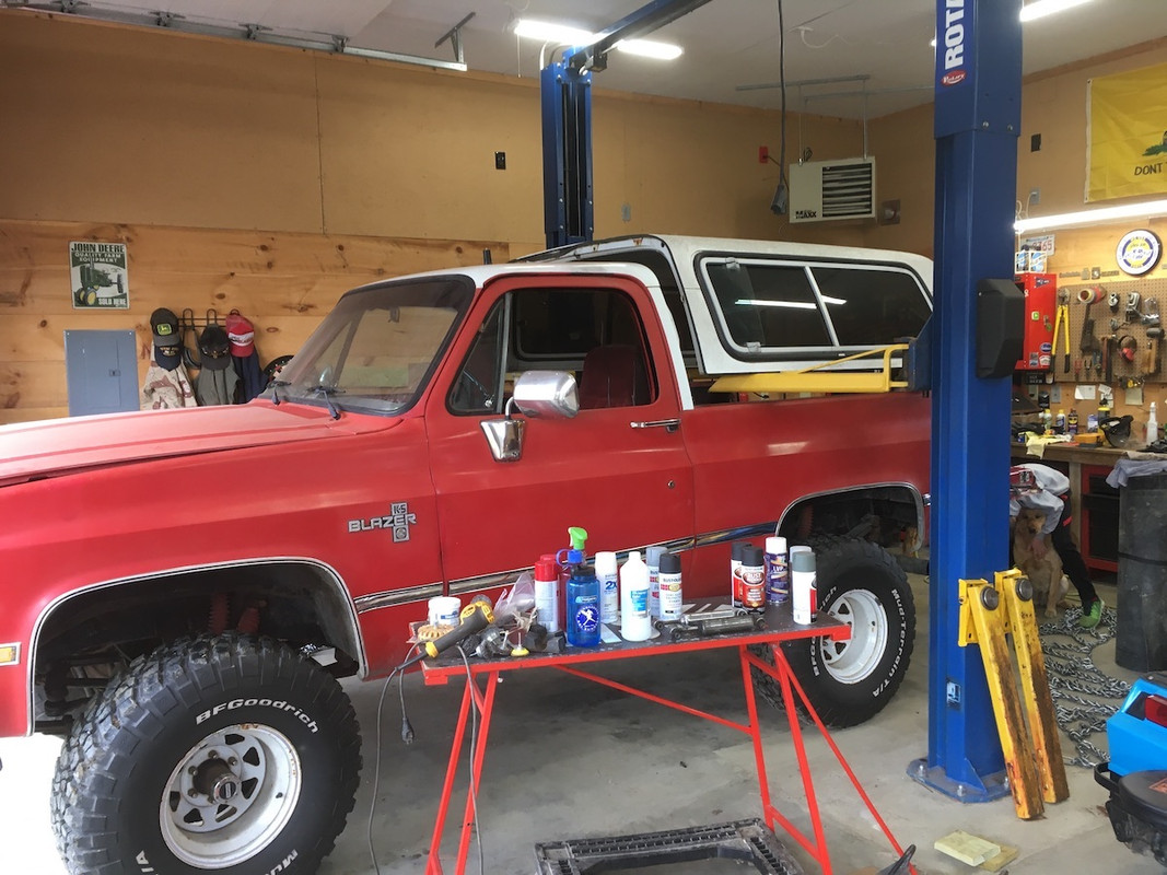

Pulled the top off to get some more light in the cab and make it easier to work on the interior...even got room to park the tractor underneath.

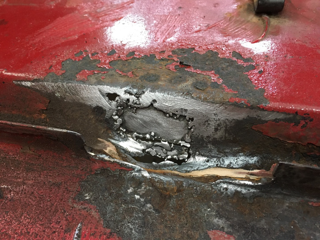

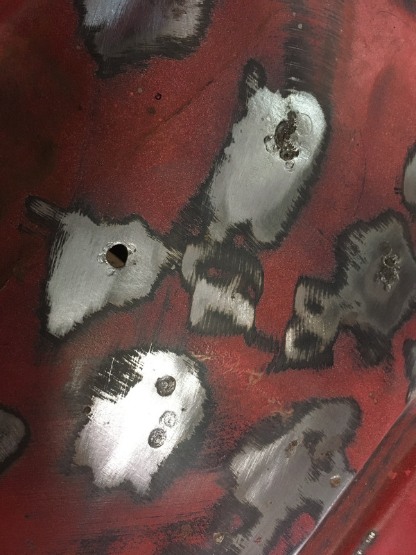

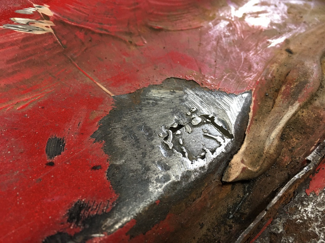

I've never welded before, but I bought a cheap little Chinese made flux core MIG to to some sheet metal work. As I began working on the cab floor I found about a half dozen nickel-sized holes and many small little pin holes. I welded in small little patches on the bigger holes. And I used Eastwood soldering butter and lead rod to fill in the small pin holes. I then used JB weld to fill in the pin holes just to be sure. I suck at welding...but I think I am getting better and I like learning something new.
bigschuss is offline   Reply With Quote
Old 05-04-2021, 08:52 AM   #24
bigschuss
Join Date: Nov 2016
Location: Savoy, MA
Posts: 70
Re: Starting the interior of my '84 K5

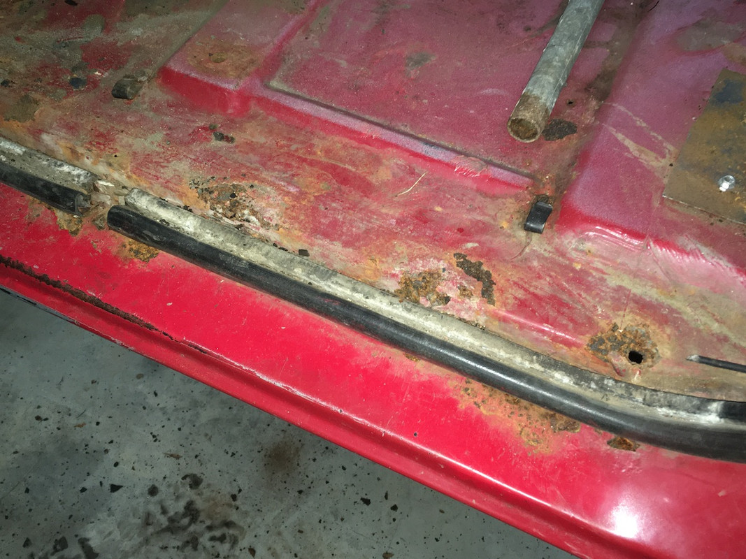

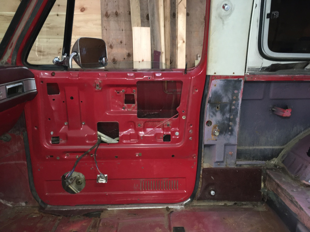

Not everything is going well though. Had a bad window sash and tried for days to remove the glass from the metal sash...ended up busting the glass on my last attempt.
Cleaned the entire floor in preparation for POR 15. Kind of a pain as it's a 3 step process. A lot of people don't like POR 15. I used it as I was meticulous in the metal prep work, and it won't be exposed to UV light or the elements at all. Two coats...happy with how it came out. The bed had no rust issues at all, so I am just going to leave it as is.
In between the rust issues and coats of primer and paint, I added some silver exterior side moulding and a set of Bully steps to the Blazer.

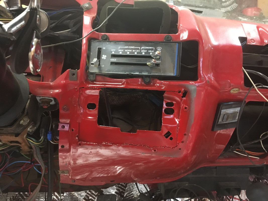

And I got my radio patch panel in place. I was not confident at all in my ability to weld in the panel perfectly in place. I cut it oversized and used a few rivets to hold it in place. Then I welded the rest as best I could. Worked fine and will hold my OEM AC Delco radio I have going in.
That's all for now. Next up...sound deadening Kilmat, carpets, speakers, CB, dash, interior trim, door panels, and seats. Hoping to be on the road by June 1st.
