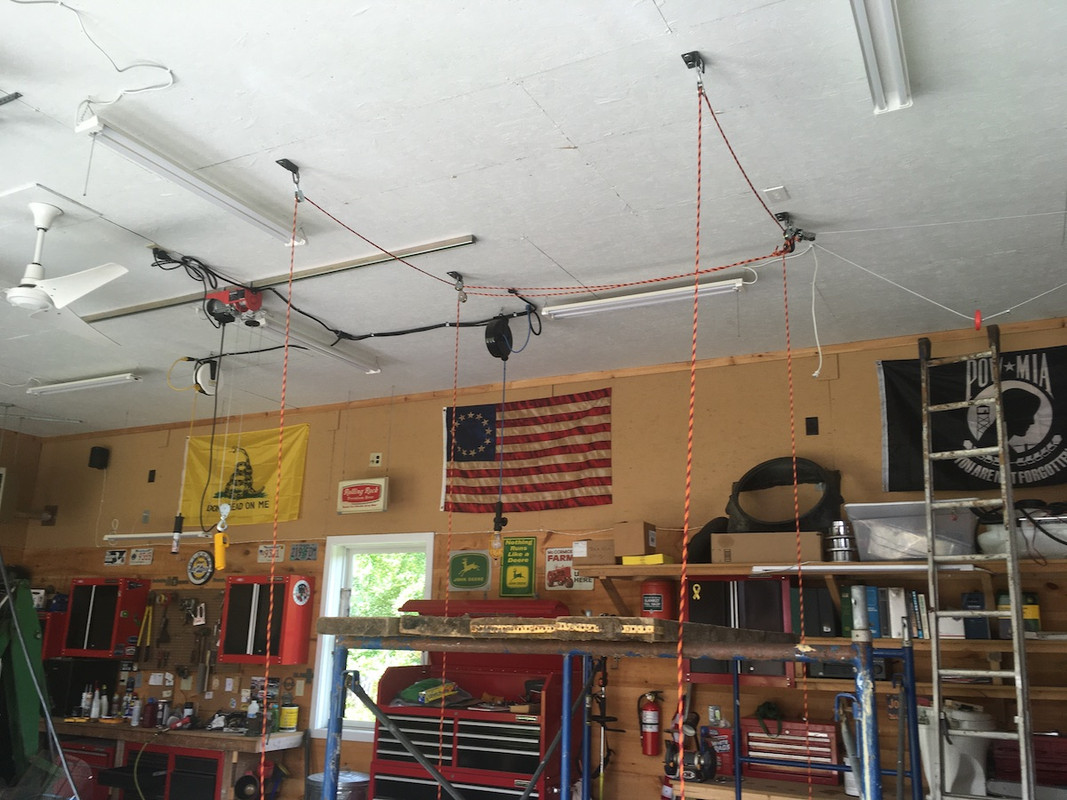

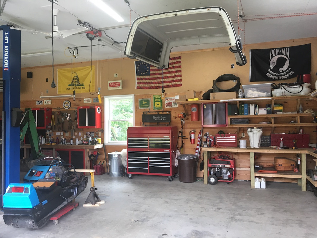

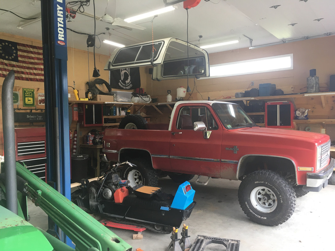

Rigged up a Hoist for my K5 Top
Been wanting to do this for a while. I used to use my Rotary lift, and that worked good, but I wanted something that would store the top all summer up and out of the way.

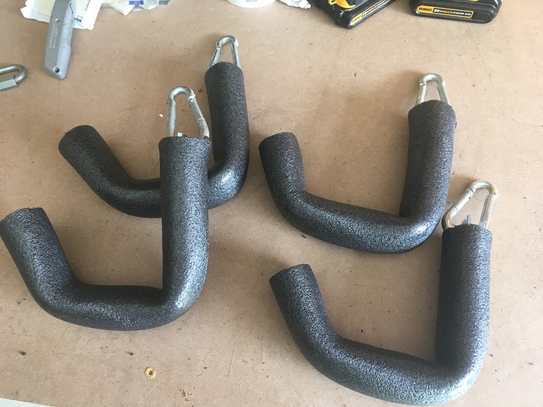

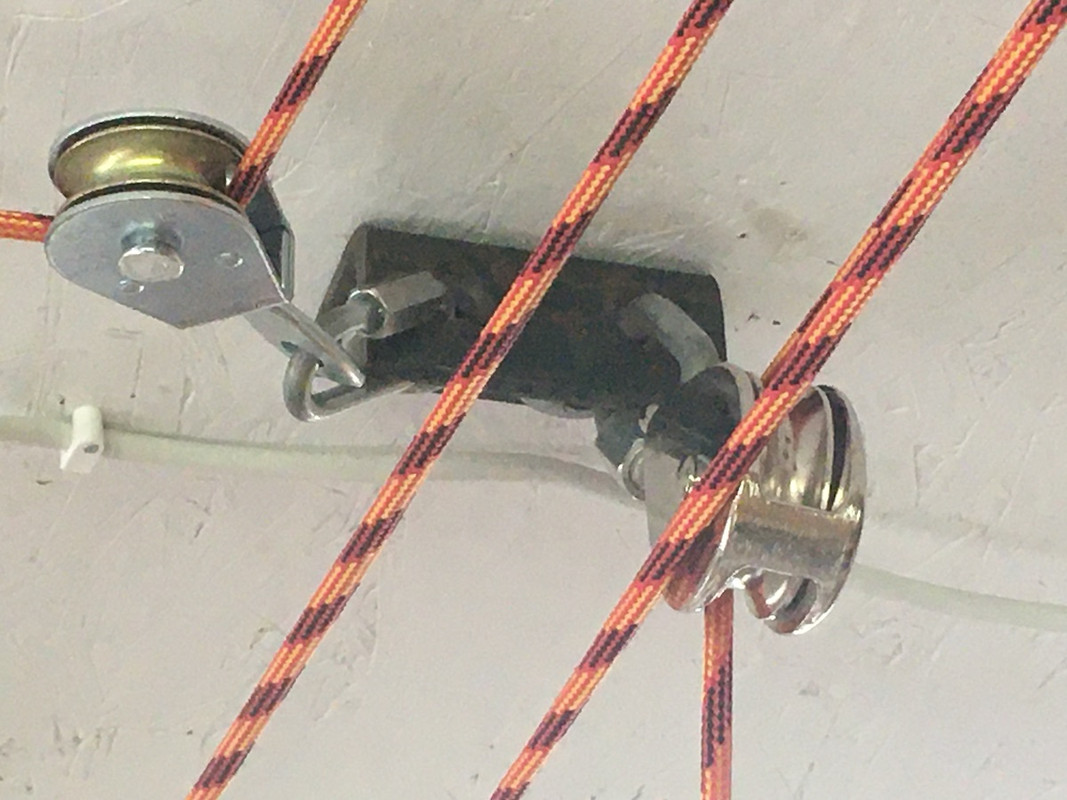

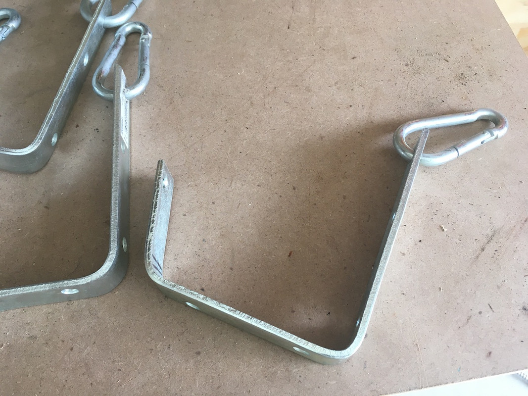

Bought some 8x8" L-brackets from Home Depot and bent them to shape and covered them with foam. I also had to buy en electric hoist from HF and some pulleys. Everything else I had laying around.
Works pretty good. Gets the top up high and out of the way without tying up my lift all summer. Think I need to add some kind of a catch or hook or something bolted to the wall so I can take the weight off the hoist once the top is lifted to the ceiling.
