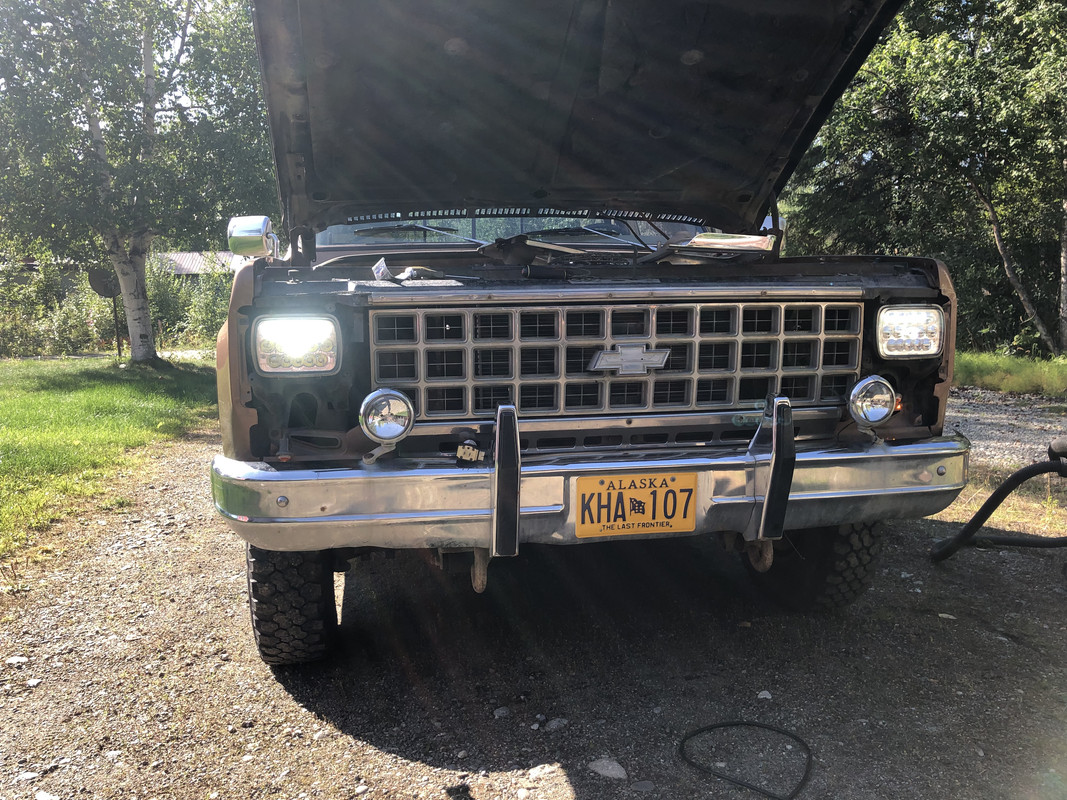

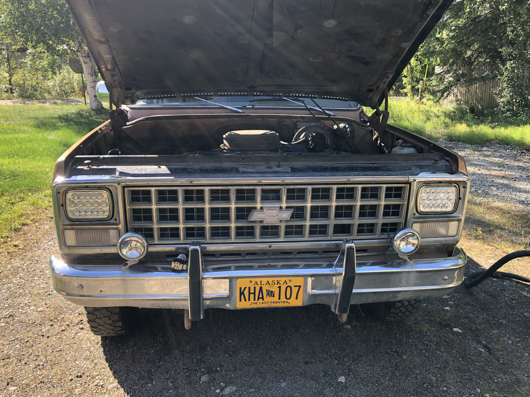

When I was driving home initially, I noticed that I had no low beam lights. I figured the floor switch was bad, so I picked up a new one.

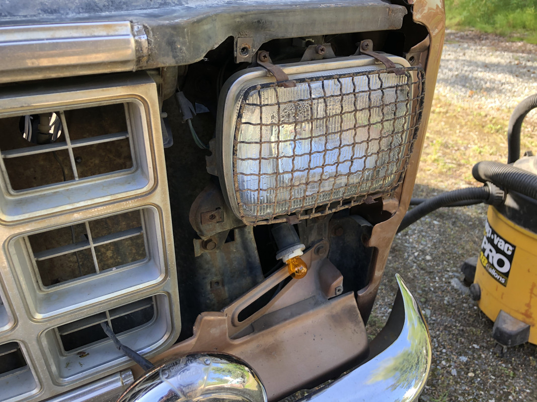

Turns out that wasn’t actually the issue, both headlights were just bad, but I had planned on upgrading anyway, so I had this extra set of LED headlights handy that were leftover from another project!

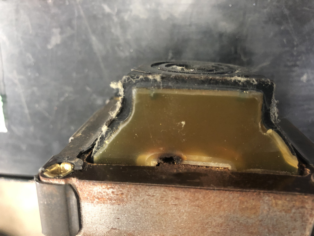

Started by removing the old, water filled headlights and guards.
New lights installed!
Low beams
High beams

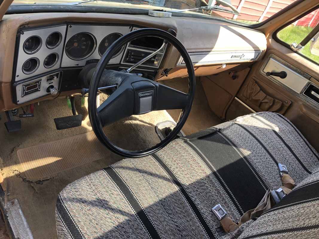

Next step, vacuumed and cleaned the interior

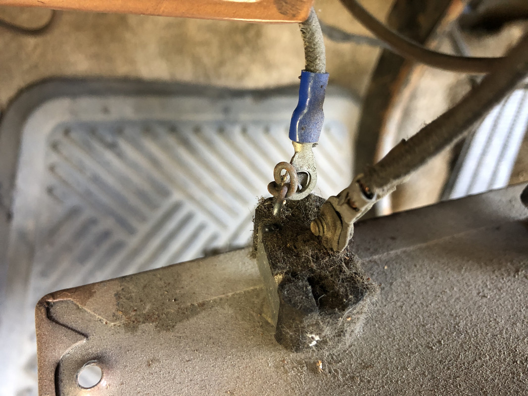

Found this impressive wiring connection on an auxiliary switch!
I took the gauges out and cleaned the gauge faces, lens, and replaced the burnt out bulbs, which most of them were. I removed the CB radio and all of the aftermarket wiring in the truck. The fuel gauge was on a separate switch from the tank switch, which turned out that it was simply a cut wire from the auxiliary tank that was never repaired when it was removed.

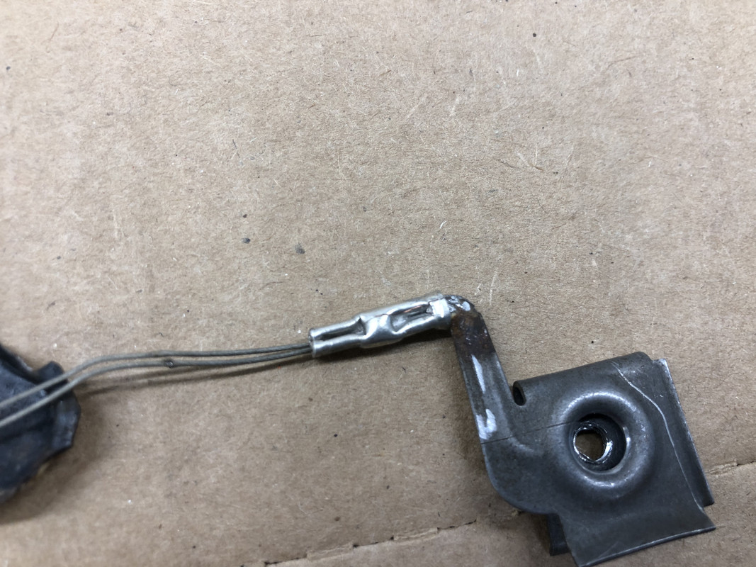

The PRNDL indicator was broken, so I did a quick fix with an electrical crimp, just to have it functional.
