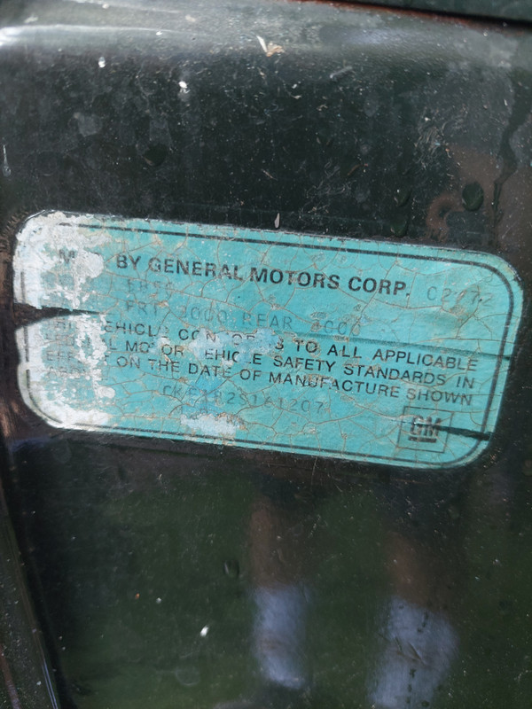

I only have recent pics on this PC.
My door latches were also repainted over, can't remember how they were when I bought it.
Built 02/72
