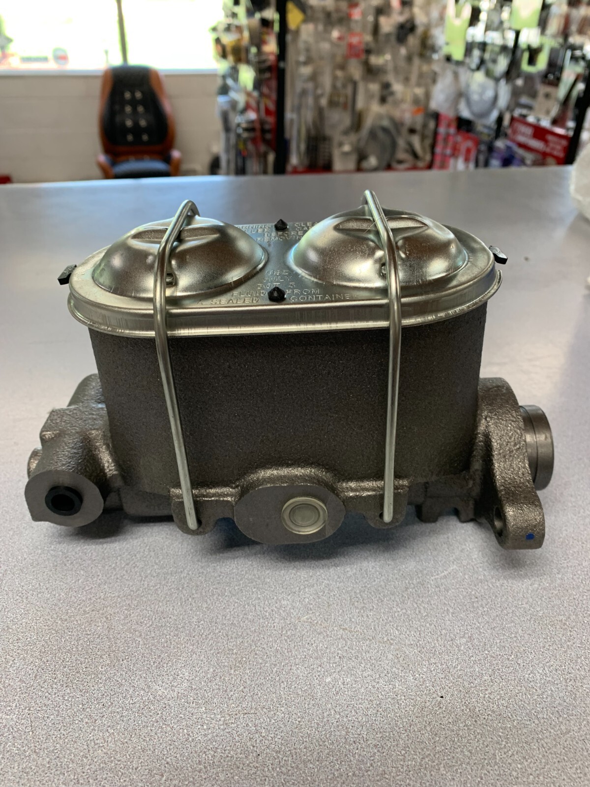

I hope this following information may help someone else when trying to replace this specific style of Master Brake Cylinder.
A frustrating and lengthy update about my previous post from late October.
I had ordered an AC Delco Professional Master Brake Cylinder #18M1036 from Amazon.com
Waiting 2 months I called Amazon to see what the delay was.
Turns out the AC Delco part was not in stock with no update/communications, just a pending on my bank account.
I then called AC Delco customer support and was told the parts would be available mid December.
A week ago, Amazon then shipped the part only to find out the wrong master cylinder part was in the correctly labeled AC Delco box.
I returned the part to Amazon and then ordered from Summit when assured from their Technical support that the photo of the master shown on their web site photo was indeed the correct part depicted.
Received that Summit part yesterday in the AC Delco packaging only to see another incorrect master cylinder.
It’s being returned also.
Calling AC Delco/GM Parts customer support again to find out why a different style of master brake cylinder from two different vendors were wrong, they passed the buck and said to contact Amazon and Summit to correct. Unreal.
I emphasized that the wrong parts are being sent in the correct labeled boxes.
They disagreed and said to order directly from The GM/AC Delco web site.
I found out that you cannot order from their web site and have to order from a GM dealership.
So now I’m waiting for an answer from the dealership to confirm if this style of replacement brake part is even still available.
Here are some photos to describe what I have under the hood presently and what has been delivered twice so far.
Twice two wrong parts delivered from two different vendors in the proper labeled boxes.
Maybe third time delivered is the charm. God I hope so
Sam

My hard pedal was due to the restorations shops failure of installing the wrong short piston rod between the master and the new booster.
I later replaced it with the correct longer rod.
I gained my brakes back but still need to replace the older master and bleed the system anew.
Yes the parts are made in China, says so on the AC Delco labeled packaging.
Their customer service said that they are American made. Untrue.
The customer service personnel need to be better informed.
I gave them my 1972 C10 VIN # for the correct replacement part search and they said my VIN was incorrect not enough characters
Internet vendors, Amazon, Summit Racing, Rock Auto and others show my OE style photos on their web sites (an old generic photo array?). One of several pictures shown on the internet show the bottom of the master stamped “made in the U.S.A”. That’s why I believe the photos are old examples and not current.
One AC Delco Technician that I sent my photos to, agrees with me that there might be two possibilities:
1. The newly stocked wrong parts were misboxed and packaged with the correct parts numbered boxes.
Or,
2. They replaced the OE style with this new replacement (different model) of Master Brake Cylinder.
He believes that they are misboxed. The main Customer service denies this theory.
The wrong or newer Master part is only stamped with a “S” on the bottom of the part. No other casting numbers are present. Strange.
I will report back and see if the dealer will come through with the original style master, I’m not holding my breath .
You did raise a good point though, what is the correct bore that I need.
I was told that a 1” bore is correct.
I would appreciate any input from the forum here to chime in and assist myself and others about a correct choice of an aftermarket replacement Master Brake Cylinder.
Thanks for your input volksworld

It's hit or miss with the AC Delco 18M1036 recent issue replacements. The first one I received from Amazon was the single bail unequal size reservoir design, exactly as shown above.
The second AC Delco 18M1036 unit I bought from EBAY is the correct equal size reservoir dual bail version, almost identical to the original Delco Moraine unit that came on my 1972 Blazer donor.

Yes, I ordered it on the same night, 12/14/23, that I received the first one from Amazon. I made double sure that I was getting the correct style prior to the order.

A picture is worth a thousand words.
Great ammunition to show AC Delco customer service.
Who knows why they deny any misboxed items on their part.
Your timely purchase with this photo should prove that there is a problem on this stocking issue.

Old 12-20-2023, 07:09 PM   #20
1970cstblazer
1970cstblazer's Avatar
Join Date: Jul 2003
Location: Elkland, PA
Posts: 2,501
Re: Correct Master Cylinder
The marking on the correct master:

Thanks for the photo.
I am still not able to locate an OE replacement style master cylinder with the double hoops.
The link you sent doesn’t offer or list this part anymore.
They haven’t responded to my inquiry yet. You may have gotten the last one from them.
A couple of eBay sellers won’t confirm what’s inside the box and or even attempt a visual check.
The stock Ac Delco photos these vendors show are of the old style and need to be updated.
