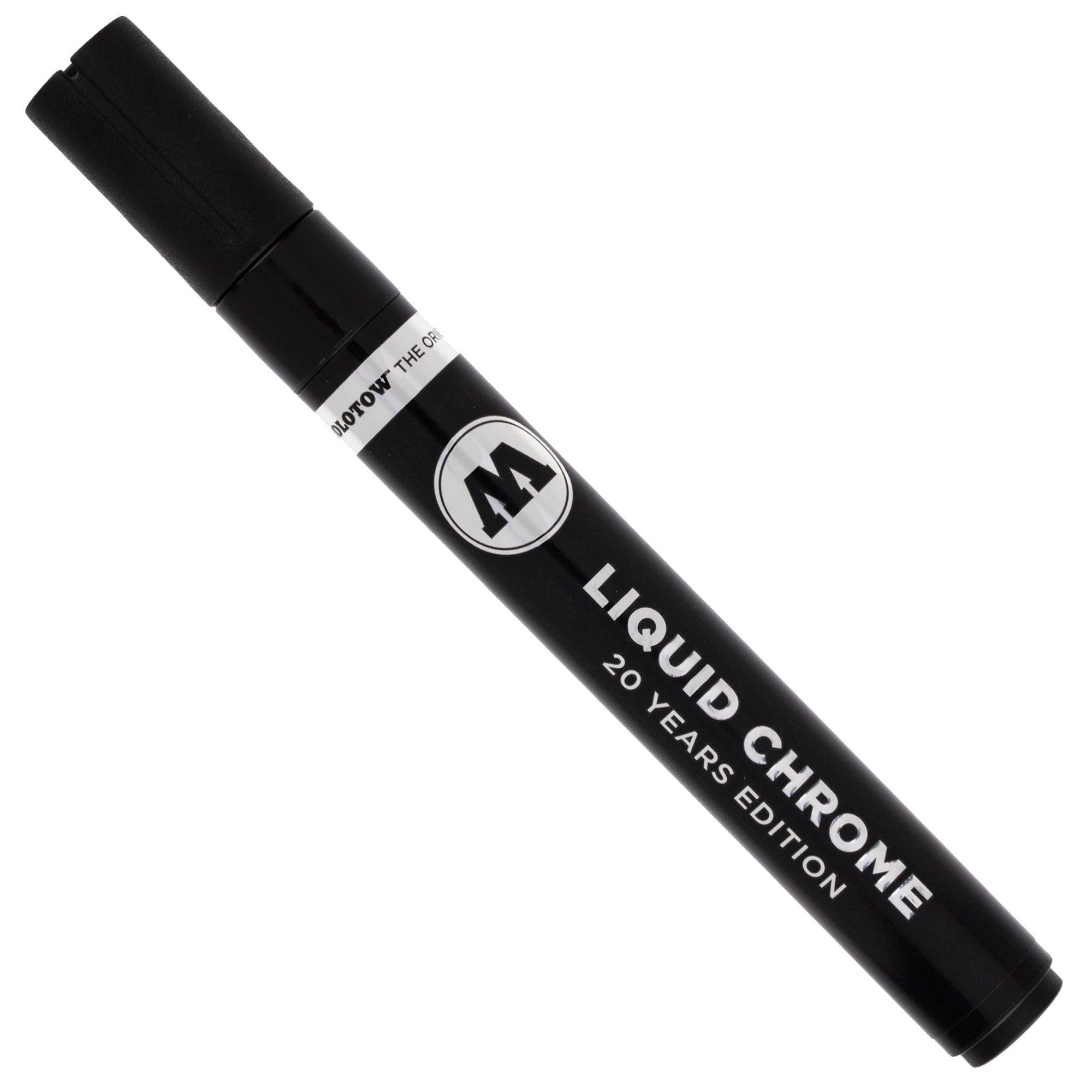

There are a few ways to skin a rodent. I'm going to try the chrome paint pen method and report back in a few months when I'm at that point. I've used them to restore interior trim parts, and build model vehicles with excellent results.
Subscribing to see how this turns out. I sprayed mine black but have not painted the silver yet. If this works, I will do the same.
