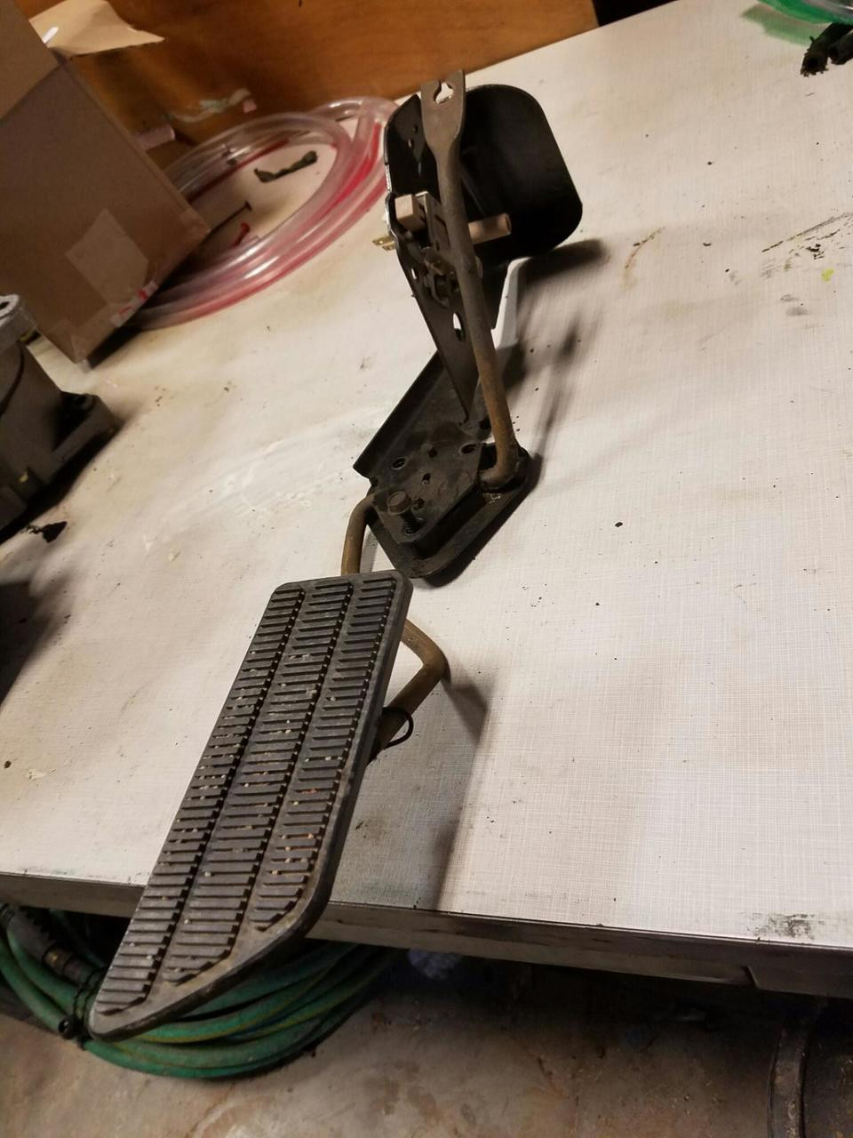

With a BBC installed, it seems like someone must have replaced the original gas pedal with one from another vehicle? Here's a square body truck gas pedal with a THM 400 kickdown switch. The switch is near the top of the picture. It's the tan parts.
This one is for sale for $25 from a guy in PA.
https://www.hillbillywizard.com/cucv...bly-for-th400/
If you use a microswitch or other low current device you might want to consider using a relay to go with it.
If you have a column mounted dimmer switch you could use the old floor switch to control kickdown. I have done this and it can be nice to force downshift at light throttle for a little help accelerating or going uphill.
