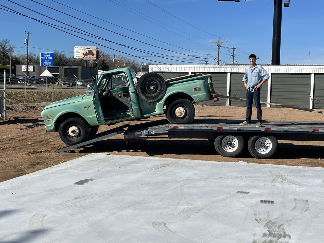

I’ve never owned one and know nothing about em. I am familiar with 203’s and 205’s. One of my boys is doing a total restoration on his 68 K10 short Stepside. It will basically be a new truck when he’s finished.
