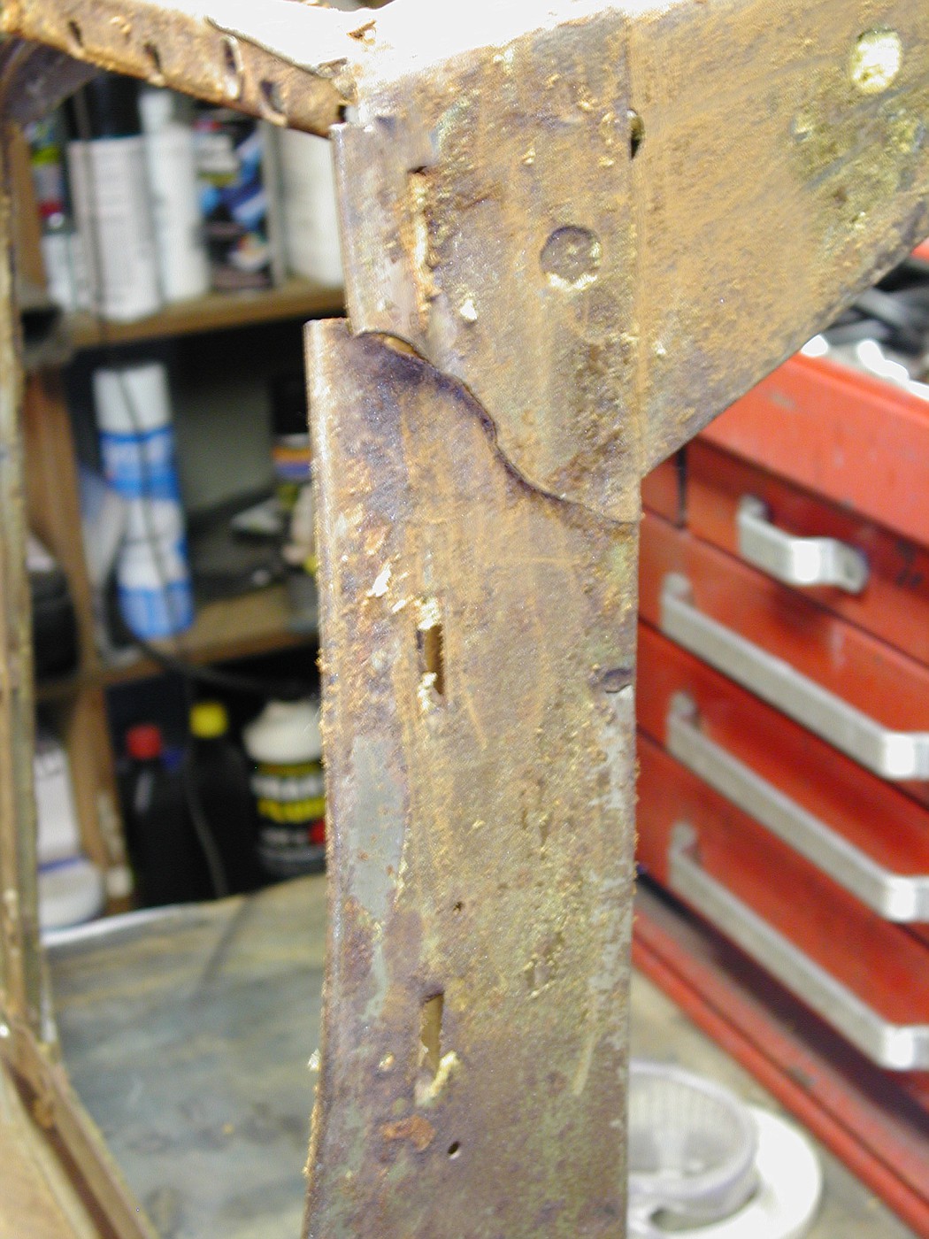

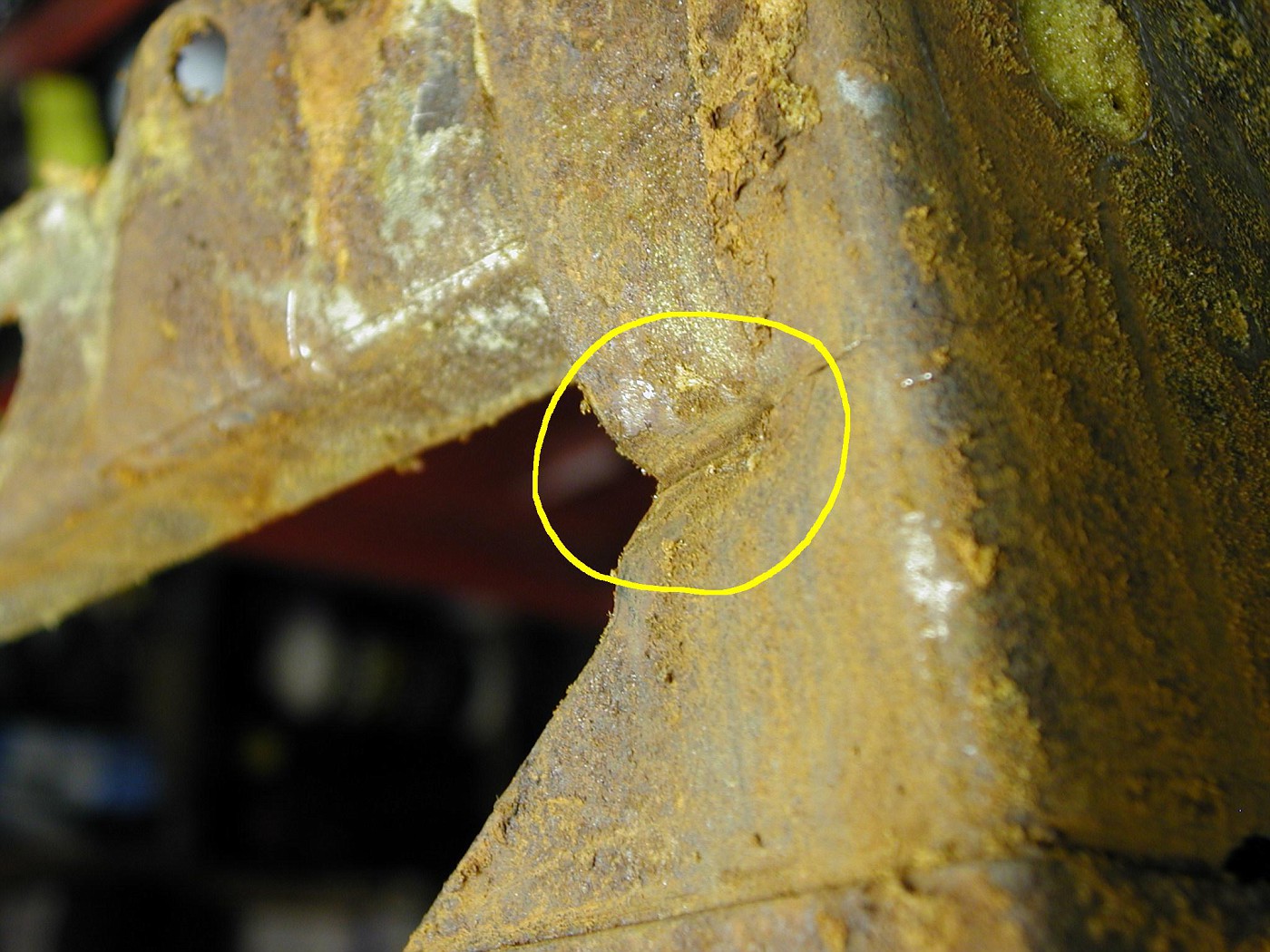

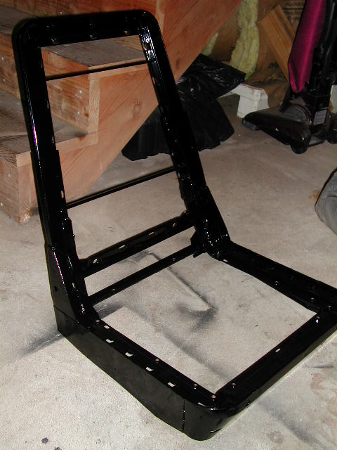

Back in 2003 when I redid my buckets I had cracks in the same place 7D2N has.

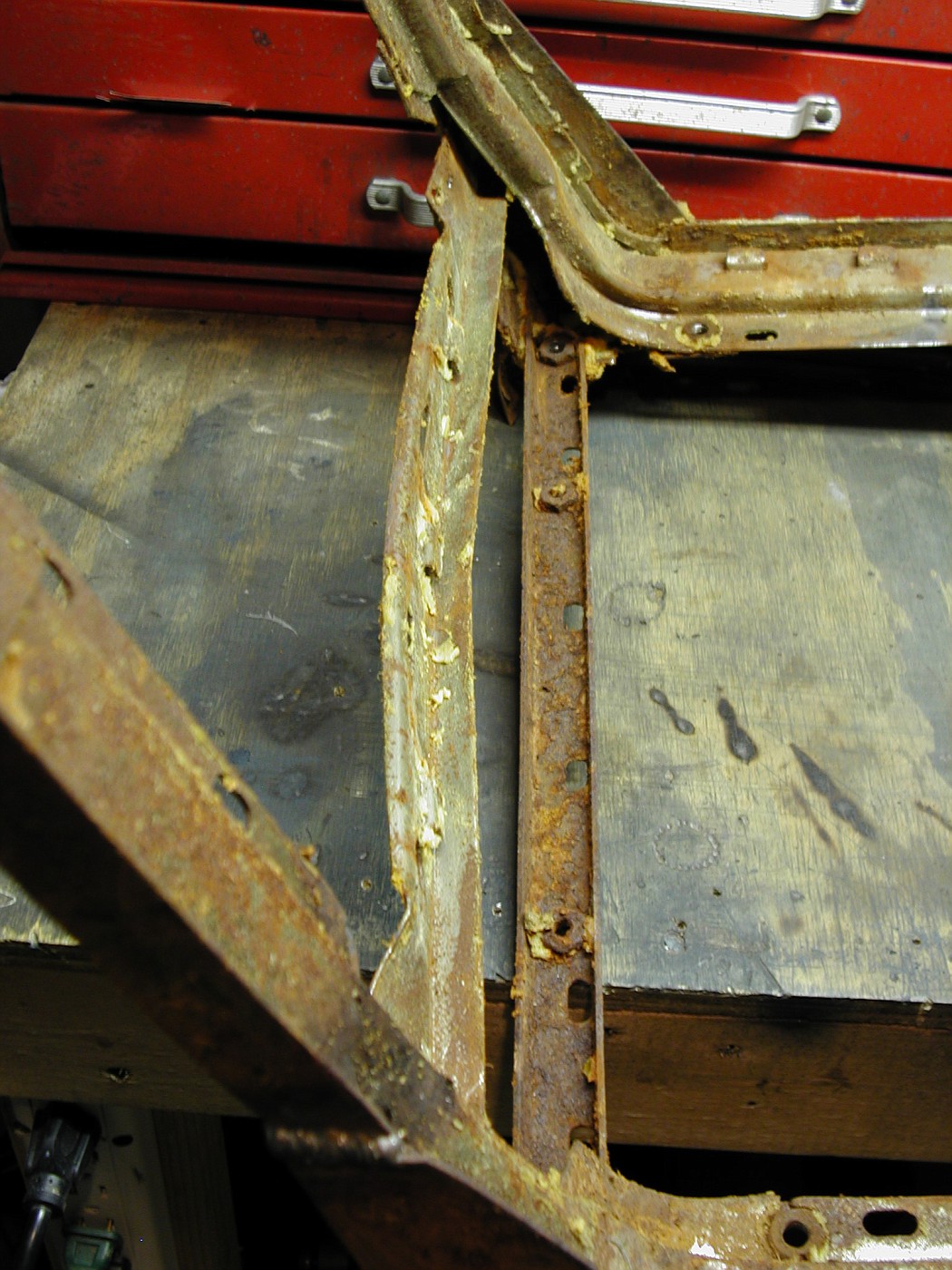

I also had cracks and deformed crossbraces higher up on the back of the bucket.

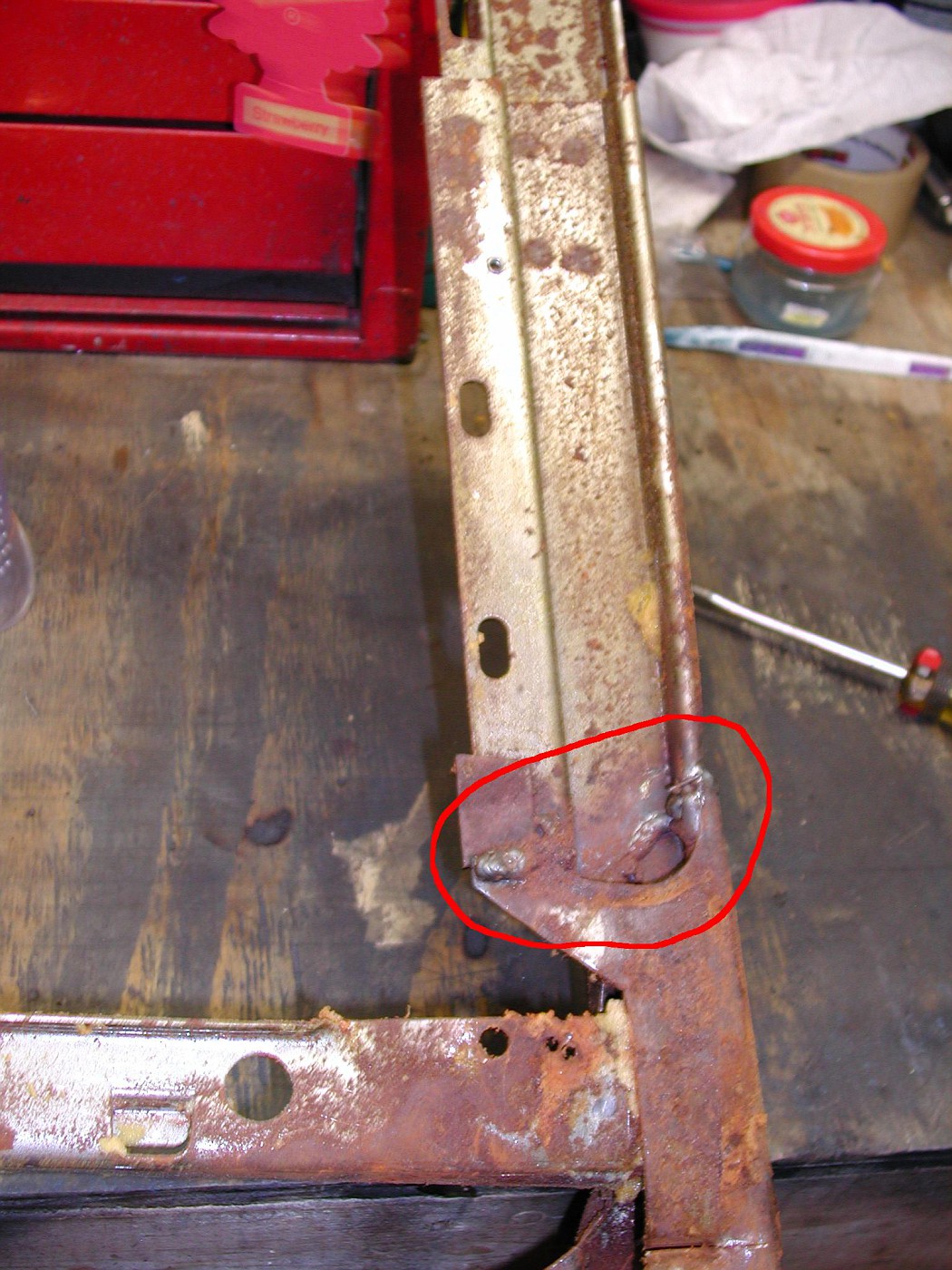

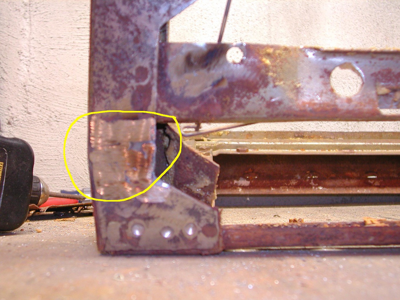

Side skirt cracked and rusted
Had to weld up cracks in the back

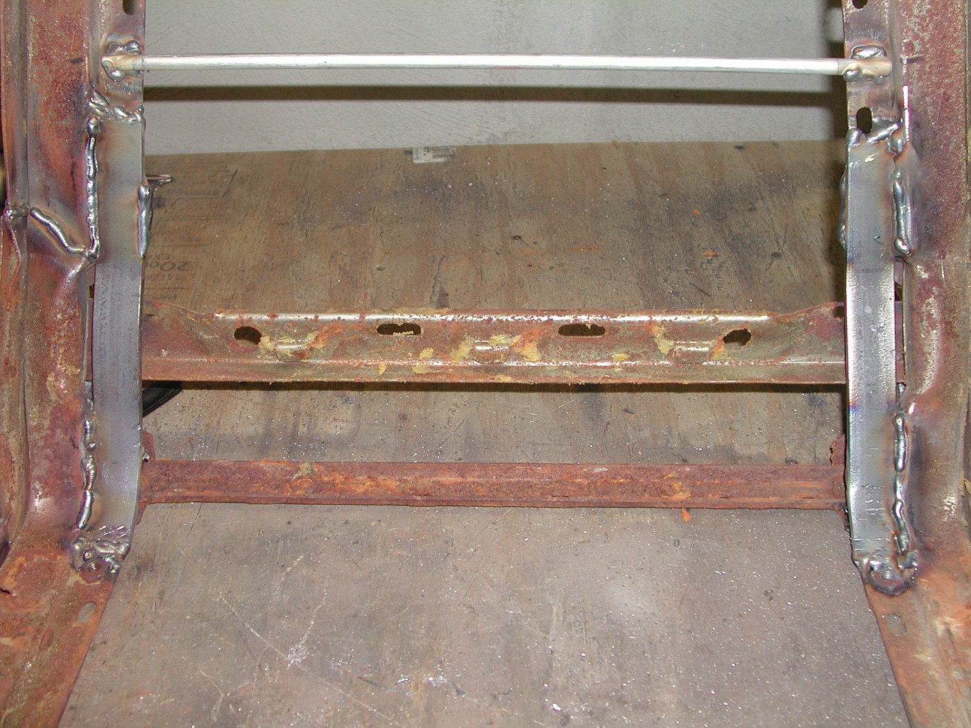

deformed cross brace.
welded up this area on both sides.
formed up and welded in two 1/4"x1" metal to brace the Base to Back area.
Then had the frames powder coated.
