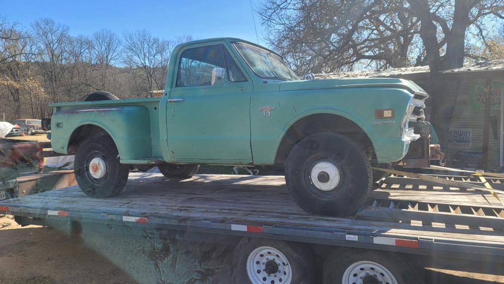

Question…what years are the front fenders the same, if any, or are they specific to 68 ?

The chevys are specific to 68, but the 68-72 GMC fenders are the same as the 68 Chevy. The 67 chevy is the same except for the missing marker light.
Looks like a nice truck, Good luck, Rg

All of the GMC's have the rounded front area on the fenders like the 67-68 Chevy fenders. 69-72 Chevy fenders have an indented area for the 69-72 style grill.
