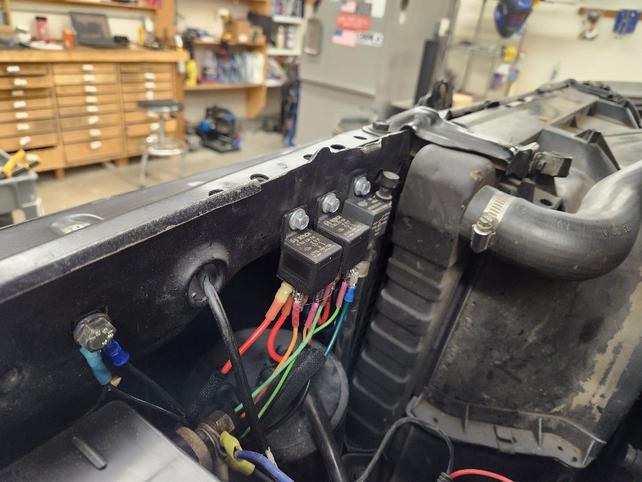

Hello all,
Thought i would share a mod,,
I am adding headlight to the front of my square until it is the brightness rid on the road. I DON"T CARE anymore.
I was passed by a new f350 the other days and from the factory it has ~8 headlight on at one time.. I am going to add lights until i get a ticket. I will still run my original two low beam to be respectful of other classics
Here is my mod.
first, with a series of relays or one sweeeet MSD 4 channel + one diode i change the OEM lights They get battery source power and when i switch to high beam the lows still remain on.
Second. I have unused cruise control. With that you get neg ground, 1 constant and 2 momentary. With this combination i am adding Hella black magics without having to cut up the dash. I can turn on 3 more circuits from the multi stem. If you did not have cruise, you could swap in a cruise multi-lever. I currently have two hellas in the bumper. Mounting 2 more on top of the bumper that i can aim. I also will add 2 more bk magics in the bumper. I will then have 10 headlight on when i pass a cybertruck or some other ignorant new car
Anyhow,, I will add more pics as i go, waiting for the MSD relay. all of the wires are easily accessible.
If anyone want some wire diagrams i will sketch some up

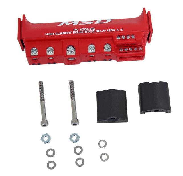

the is the relay i am waiting on,, cleans up a lot of spaghetti.
https://www.summitracing.com/parts/MSD-7564-HC

A little follow up. Using the MSD relay is the only way to go,, so clean and easy.. has neg or pos trigger.

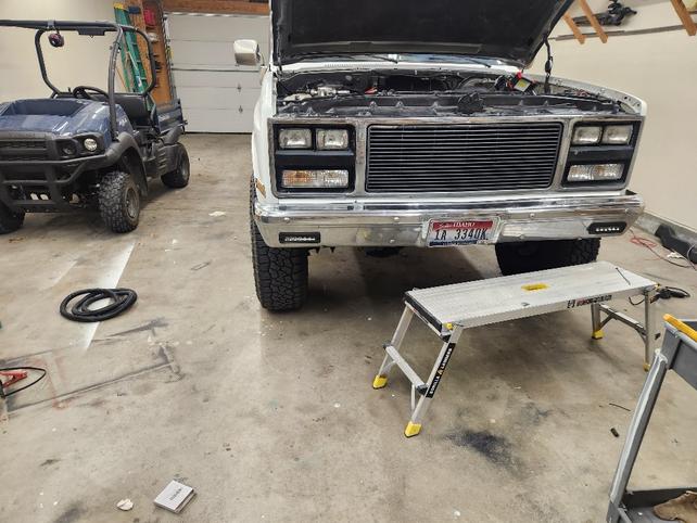

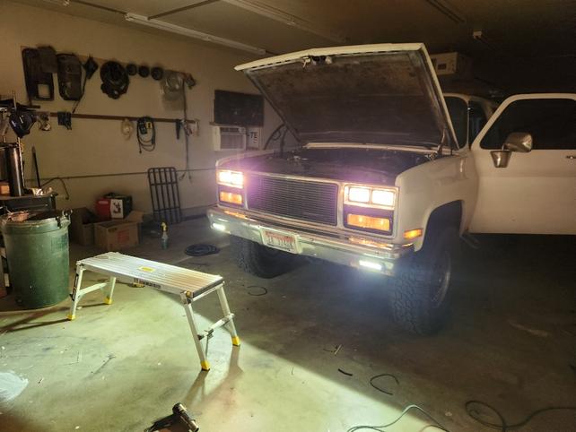

Full Retard Complete,
I kept the OEM warm color high and lows so not to blind innocent people
THe recessed hellas come on with the ON setting and the pedestal mounts come on with RESUME. both turn off together..
Still Half as bright as a modern car.

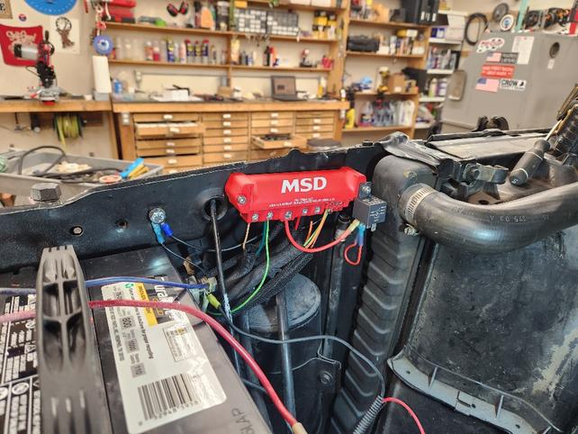

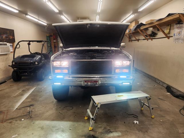

Finally update,
Never sourced the proper latching relay. With MSD i get battery source power to the lights.
Channel 1 is low beam
channel 2 high beam
a diode allows the high to keep low beam on so now 4 lights on high.
Cruise stalk,
channel 3 via ON triggers the flush mount bumper LEDs lights.
Channel 4 via RESUME triggers the top pedestal LEDs.
using a diode again,, the extra bosch relay has a jumper from channel 3 to keep the 5 pin on and this triggers channel 4.
Turning off cruise control turns off both. channel 3 must be one for channel 4 to work. It is okay because to actuate resume, you have to turn it on anyway.
A little messy but got what i wanted. Looking now for decent Beam Leds for the top. Currently all LEDs are flood.
