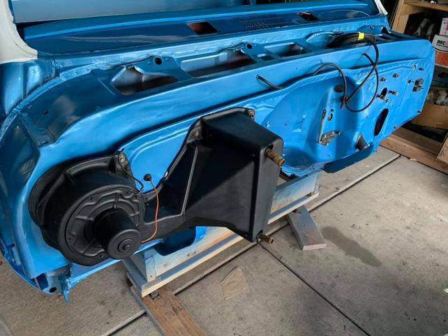

After six years they still look the same.

No clear. I polished the original finish because it was still a good one. That picture shows one side polished, the other hadn't been done yet.
If the case' material is the same throughout, in other terms never had an exterior finish coat? then seems to me you can blast or whatever, then polish to heart's content where original appearance is desirable.
That polish brought the original appearance back, and lasts. I've only dusted it since.

So heater box is finally back in. Rolite for the win! 3 coats is what i went with. Mine doesn't quite look as good as Tony's, i was hoping for a darker finish, but I'm somewhat happy with how it turned out. I don't know if i over sanded, but my fiberglass looks quite course. There is no mistaking it from one of those newer made in Taiwan boxes, it looks clearly original, which is what i was going for. But dang, those satin black ones still look really sweet!

Looks good. Given the new paint on the FW and fan housing, be sure your grounding lead is contacting bare metal. Especially that sheet metal screw to the firewall. My lead worked for a year and then out of the blue, quit. I waisted most of a day because I failed to check the basics first. Turned out the screw lost continuity to the FW even though it was still tight. Also, that hole in the fan housing is for a vent tube on a AC truck. There isn't much water in the area but I'd address in some way.
