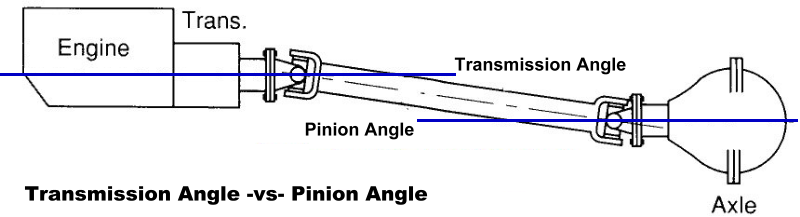

This first drawing came off some group on the net and the front half of the two piece driveshaft being and extension of the crank/output shaft line isn't going to fly 90% the time.
The second one is off the Spicer how to use our driveshaft angle gauge but their page may need an engineering degree to follow https://spicerparts.com/anglemaster/measuring-angles Still it shows what most of us have with our two piece driveshafts.
