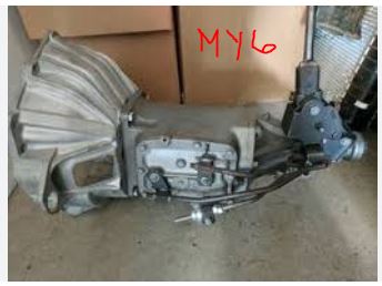

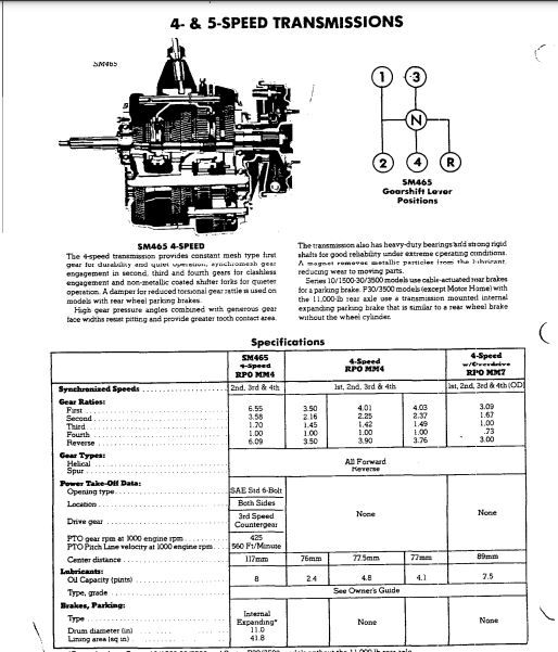

Can you be more specific about which "Muncie" you speak about?
If it is a passenger car type 4 speed then you would have the only one.
The actual two choices for 1983 would the SM465 RPO M20, which is the three forward gears plus a creeper (low).
The other is the MY6 New Process overdrive trans, which was a MOPAR trans with third geared 1:1 and fourth gear as an overdrive.
I am not aware of any official production records for 1983* but if it's the M20 we made several hundred thousand (probably 1/4 to 3/8 of all K10 production).
The MY6 would be more rare but still it's a regular production option so we built more than a few.

Generic info packet from the GM Heritage Center archive for '83 pickup:
https://www.gm.com/content/dam/compa...olet-Truck.pdf
