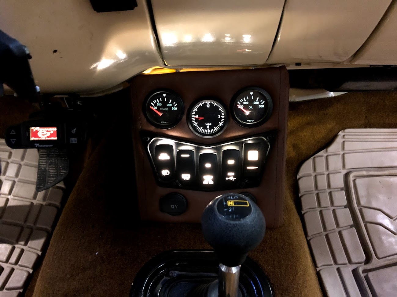

For the interior, I installed a new carpet, overhead console, gentex mirror, sound system, inverter, trailer brake controller, and a custom gauge/switch pod that mounts under the dash in front of the 4wd shifter. A couple pics here:
Overhead console out of a 91 Suburban, and Gentex mirror from a 99 Silverado
Gauge and switch pod with USB/12V power ports

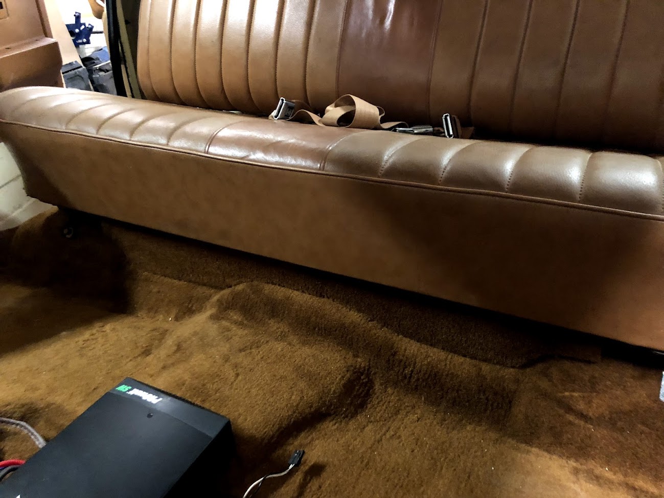

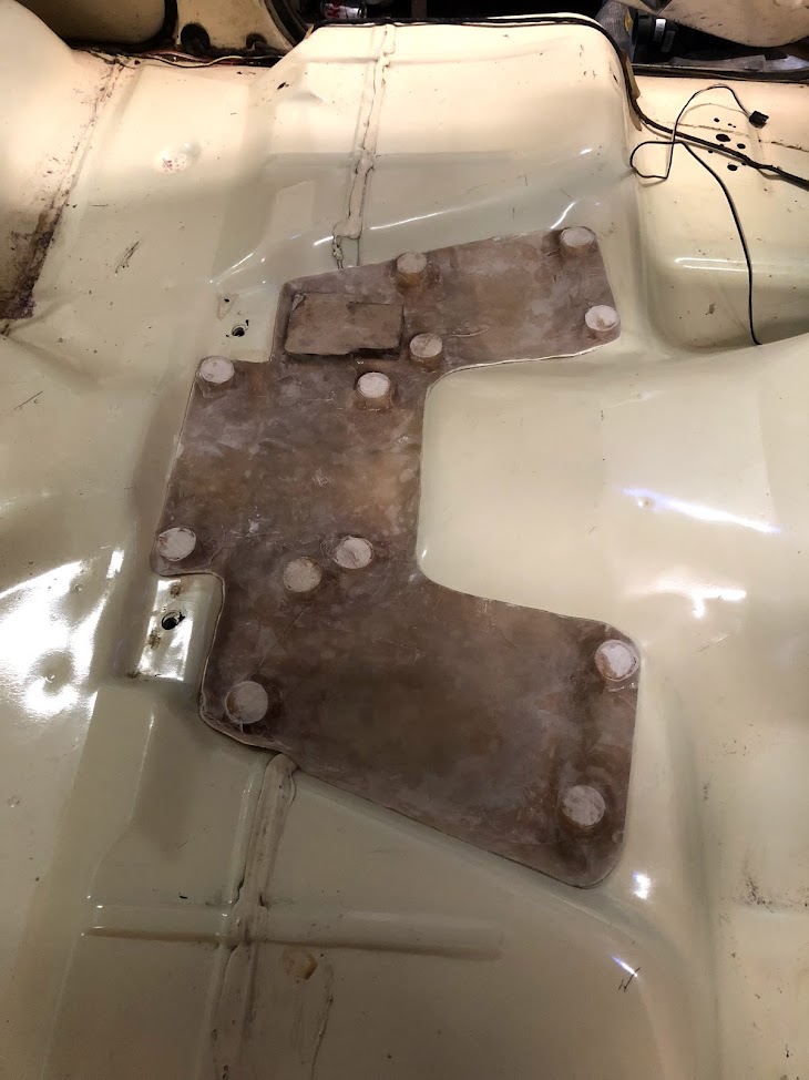

Fiberglassed an amp/inverter rack to go under the carpet below the front seat. Wooden dowels serve as mounting pads for the components.
Amp rack with components installed

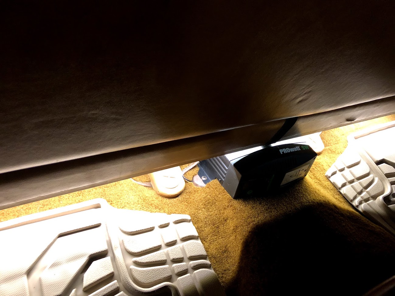

With the front seat installed, all you can see is the face of the inverter sticking out towards the rear. Also note the LED lighting for the backseat, tied into the courtesy circuit.

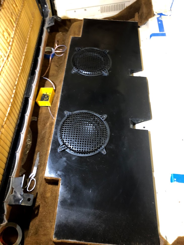

Under the backseat, fiberglassed a sub box to fit two 8" subs
Sub box under the backseat ready to cover up
All installed, you can barely tell the sub box is there!

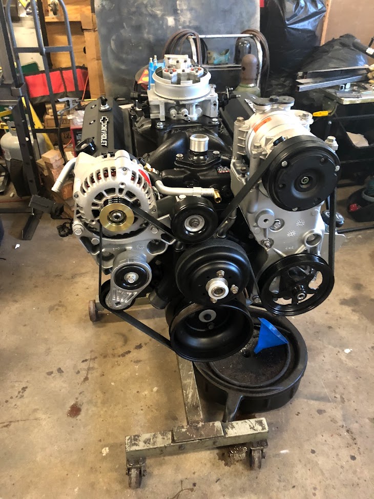

So the 350 TBI was running great, but as we all know they aren't exactly the most powerful V8's around in stock form. That became especially apparent when I bought and dragged home a 34' 10,800lb travel trailer from about 2 hours away! It's time for Belle to get a bump in oomph.
Over the years I've built a few engines for myself and a couple other friends, mostly 350's but one 454 and a couple other oddball engines too. For this build, I wanted to do a 383 TBI stroker, retaining a stock appearance but with as much torque and "sleeper" power as I can fit in there.

A quick rundown of machine work and component selections that went into the engine build:
-Block bored 0.030" & decked 9.015"
-New Chevrolet Performance Vortec heads, worked over with 3-angle valve job, lift clearanced, pushrod clearanced, Z28 springs, resurfaced
-Eagle 383 rotating assy, balanced, 9.4:1 compression
-COMP Hydraulic roller 206/210 @ 0.050 w/ new OE lifters/chain
-1.6 roller rockers give 0.489"/0.489" lift
-Performer RPM Air Gap w/ TBI adapter plate
-5.7 TBI unit bored to 50mm, flow-matched injectors, injector spacer and bumped-up line pressure
-PCM reprogram using TunerPro and APU1 emulator/programmer/datalogger with MSD wideband O2 sensor
-Hedman Black Maxx headers
-Hooker Max Flow mufflers w/ new 2.5" dual exhaust
-Front accessory brackets of 98 vortec 5.7 truck motor
All dressed up before install

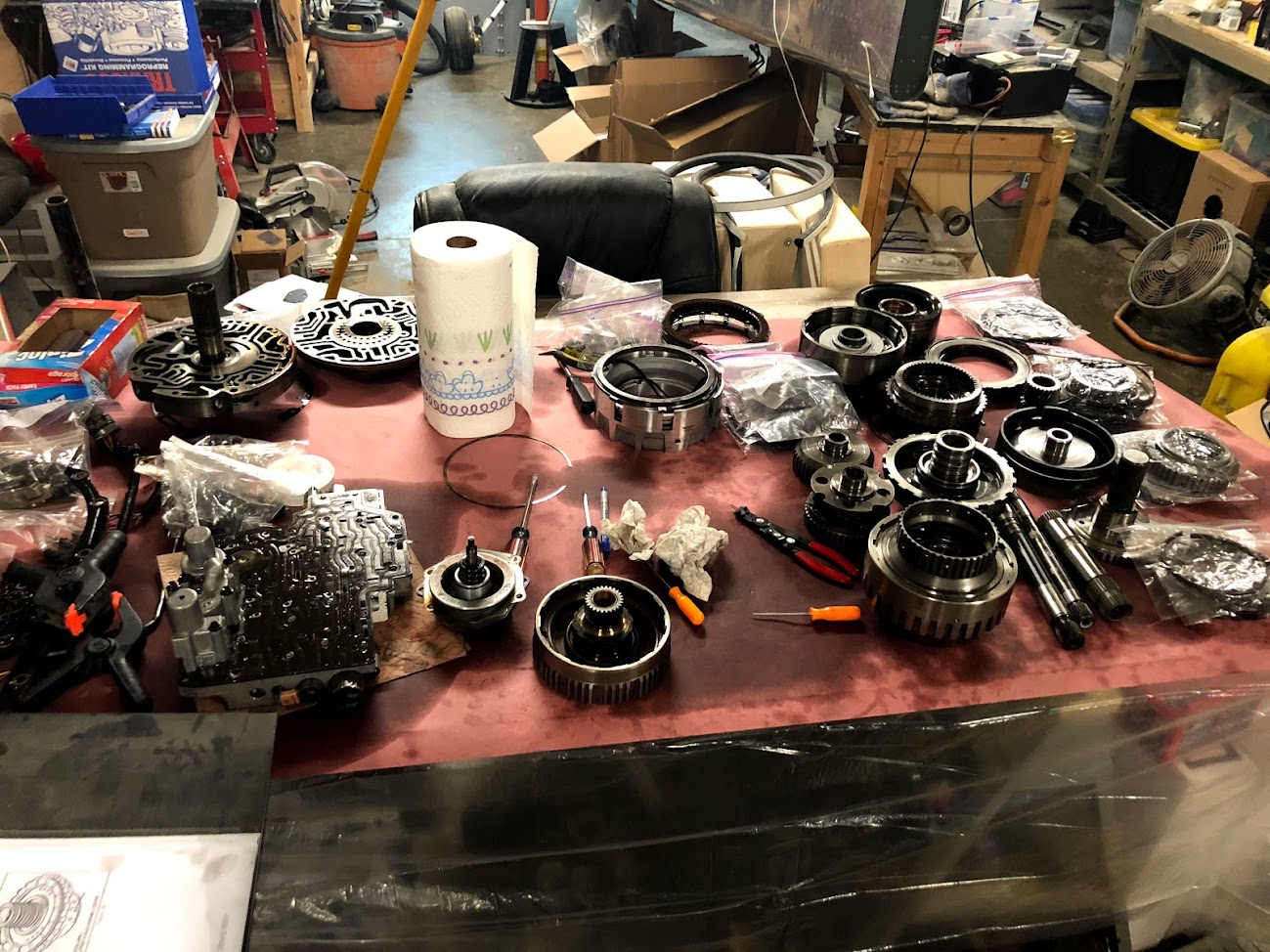

For the transmission, I consulted with Jake's Performance and ended up with their "Stage 2" overhaul kit. Tearing my core down, there was definitely a moment of "what the f--- did I get myself into??!?" There are A LOT of parts inside this beast:
The 4L80E core all torn apart, parts labeled and organized as best as I could

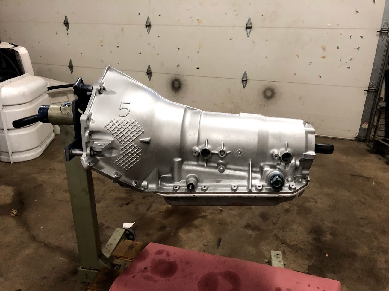

Then, after many weeks of careful inspection, cleaning, parts replacement, and reassembly, I somehow ended up with everything back together!
The complete rebuilt 4L80E transmission, ready to install
After the engine was in and running acceptably, it was time to install the transmission. While the rest of the drivetrain was apart, I decided to also grab an overhaul kit for the NP205 from ORD and give it a cleaning and refresh as well. This was my first time rebuilding a transfer case also, and although it was a bit tricky in parts, it definitely pales in comparison with the tranny I had just finished! So it seemed easy by comparison.
