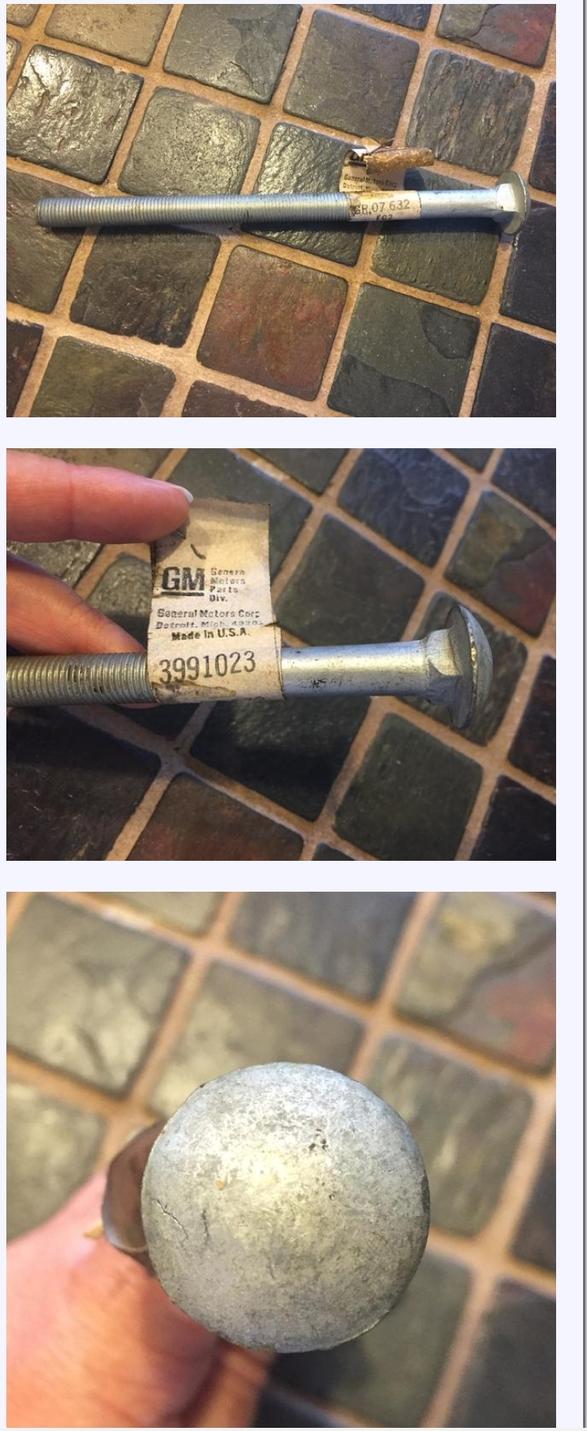

ISO Blazer Jimmy spare tire carrier carriage bolt
ISO Blazer Jimmy spare tire carrier carriage bolt & possible nut

You can borrow the one in the picture, I'm pretty sure that's mine, lol

If you are going to have them made, I would also suggest making the square part that slides in the slot longer. It barely catches and spins a lot. The 73 bolt square is a lot longer, I have one of those also I can grab a picture of.

GM’s 69-72 bolt was essentially standard head and square dimensions for a 7/16 carriage bolt. It did fit terribly loose in the slot as 1rippen6 says. The 1/2” carriage bolt dimensions fit great, but a 1/2” carriage bolt would require using an incorrect nut. A custom bolt with a 1/2” head but 7/16-20 fine thread would be the best of both worlds. When I had my reproductions forged, I followed the 7/16” carriage bolt standards (like GM) in part to be able to use existing forge tooling. The cost to create new forging dies would have been prohibitively expensive.

Bolt 3991023 is almost too small for the in bed spare tire mount. It barely catches the edges of the bolt slot in the mount.
I found that bolt 326928 fits the bolt slot in the mount perfectly but it is an inch longer.
