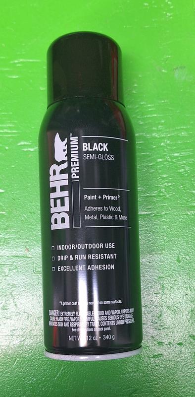

I have gotten good results with the Rustoleum paint and primer in one can. I did some a/c and p/s brackets a few years ago and they still look fresh. Wipe them down thoroughly with a pre paint cleaner and scuff the parts with a 3M red pad so the paint can get a good bite, then wipe down again before spraying. Spray when the parts are in the recommended air temperature range and you will get a nice finish. But beware. I have had problems with Rust oleum running out of propellant lately when the can was still half full. I read that this is a problem in that brand but ignored it.
The last time I sprayed small black parts and brackets I used Behr Premium paint+primer from Home Depot. It sprays nicer than most and leaves a nice finish. Also. the can I'm using now feels empty but is still spraying.
Is this what you used?
https://www.homedepot.com/p/BEHR-PRE...2144/310275636

Re: Best paint for bare steel A/C brackets
Originally Posted by MikeB View Post
yes,
