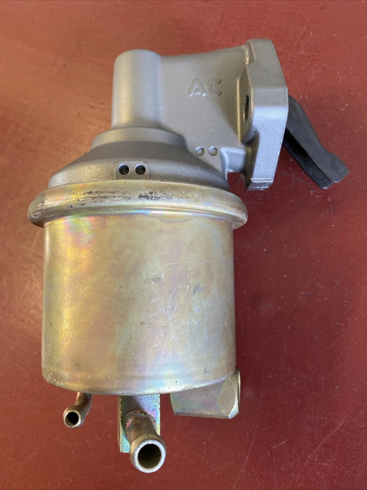

1972 Series 10-30 350 with Turbo Hydramatic transmission called for AC brand fuel pump 40867, which had a 1/4" return nipple per the GM parts manual.
This a photo from eBay and the seller may be mistaken. Another seller has the same p/n for a pump that lacks a return line. My 72's didn't have any fuel return line, just the vapor line iirc: https://67-72chevytrucks.com/vboard/...0&postcount=34

Here is the excerpt from the partsbook. Obviously, these have been wrong in the past and can't be considered gospel.
