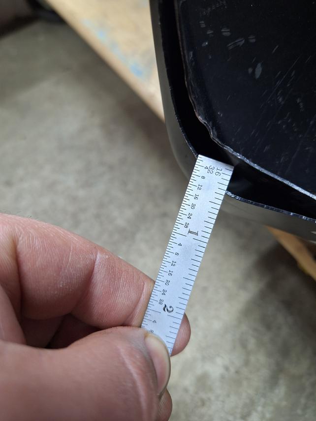

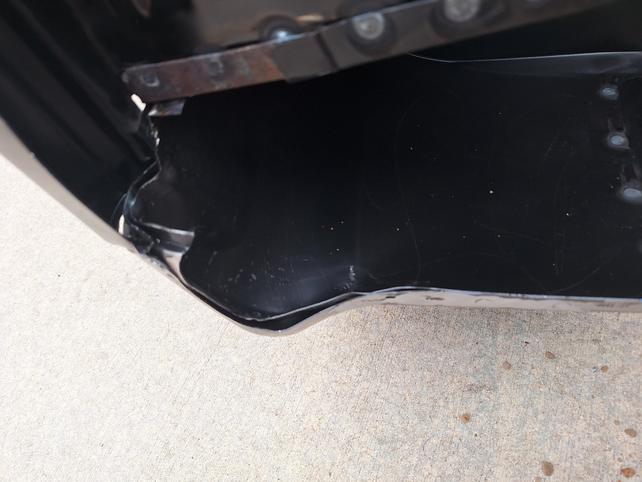

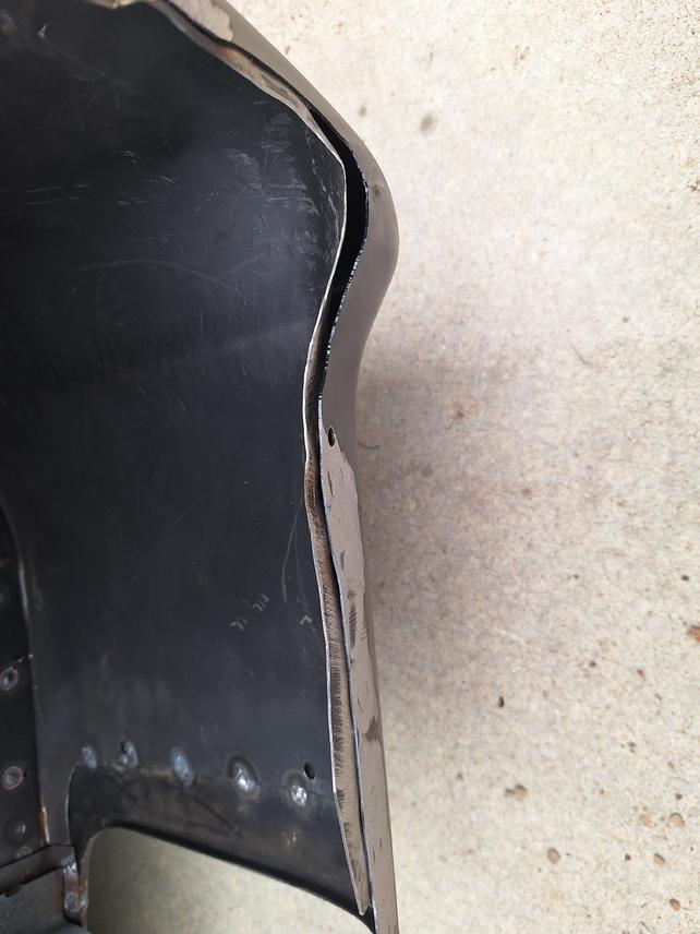

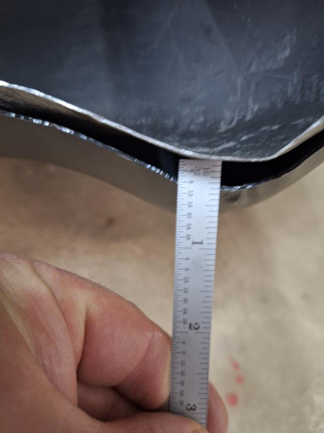

Had a shop install rockers and inner/outer cab corners for me. I got my cab back and the inner and outer corners have this rather large gap left. I'm looking for feedback on how to fix this, fill the gap. I understand the shop should've done this correctly, that was the whole intent of them doing this work and I will be addressing it with them but since I've already got the cab home I just am looking for thoughts on making this work and fixing it.

It looks like the patch panels are probably poorly formed where the horizontal pinch weld area is. And the shop didn't correct that prior to installing/fitting them. The outer skin should be longer or equal to the inner. The radius area with the large gap should have been addressed. Before they were welded in. It looks like they were installed as purchased. Which you can rarely do. And expect to get a good fit.
I would probably start with clamping the gap together. ( or closer together ) To see how it reacts. And if you can get the edges close enough to tack weld in place.
Grounded63 is online now   Reply With Quote

The first pic, doesn't look that far off. And I would expect to flex together, at least some.
Pics 3/4 looks worse, and may not come together real nice.
Once you get them together, the best you can. Get the area in epoxy, if that's the direction you are going. Then seam seal if wanted, and re-epoxy.
