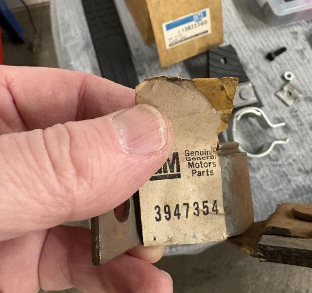

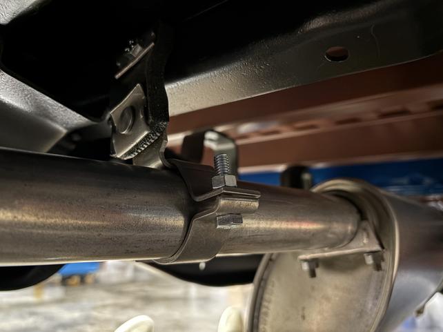

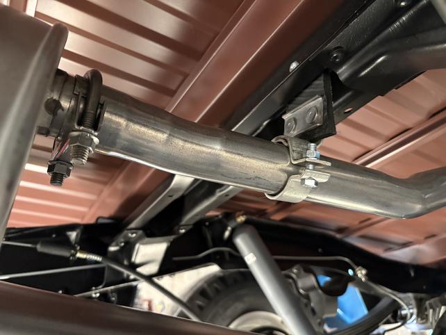

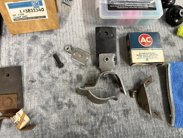

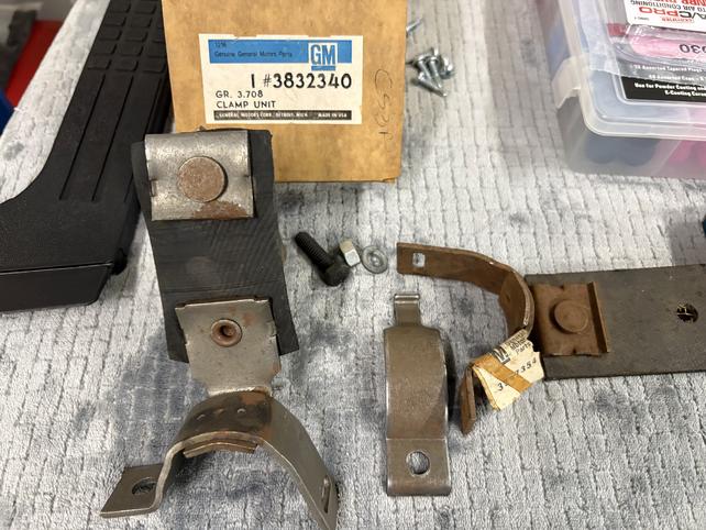

Small update on a hard to find part. As I've noted on here before, I spent a lot of time looking for the correct two piece exhaust hanger that goes behind the muffler. By the 1970-71 parts book, a couple of numbers get you there:
3948683 Exhaust clamp upper
3820977 Exhaust clamp lower
I met a vendor at a show recently who was able to put me on the closest thing so far. He had an earlier version (upper only) and a superseding kit that had an extra bracket. The kit was in much better condition, the strap was the right thickness and ended up being the one I used. I removed the flash rust and the extra bracket and swapped out what I had on there for this two piece.
On the assembly line the tailpipe and muffler would have been welded together as one piece. There would be no need for the clamp you see pictured. Even though my muffler and tailpipe are NOS and correct numbers, they are service replacement examples.
The reason the factory put a two piece hanger on in that location is so you wouldn't have to fish a single piece clamp/hanger on from the tailpipe end all the way to this mounting position. You connected the muffler to the Y-pipe and throw this hanger right on where is goes.
First pic is the hanger I had been running on there. Then a couple of pics of the new parts I located, before and after clean up.

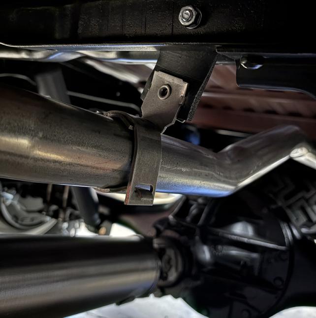

Here's the two piece hanger installed.

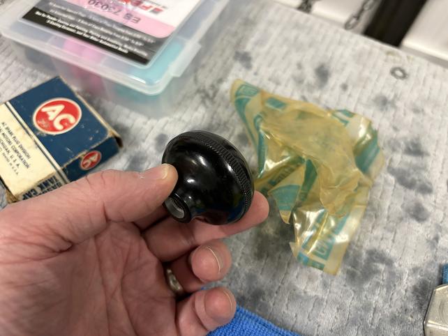

NOS shift knob- COOL!

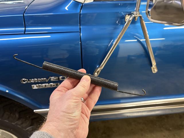

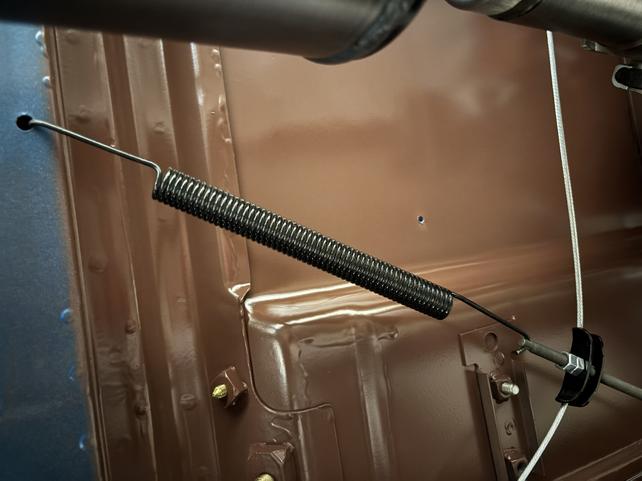

A few little updates. First...I totally whiffed on my parking brake cable spring. I can't believe you guys didn't call me on it! My cable cleared the driveshaft, (though very close) without it. We've started disassembling my brother's 70 which is very complete and original and I realized the omission. Picked up an NOS one and now the cable clears the shaft at a more reasonable distance.

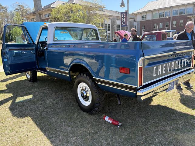

Second...As you know, I wasn't super happy with the C10 Nationals experience. Though I had a blast hanging out with board members and friends.
I've got a buddy who is a big AACA guy and he encouraged me to show the truck at one of their events. There was a Winter Nationals show about 2hrs away from me this weekend, so I hauled her up there. An amazing variety of cool cars. My brother and mom drove up and my wife and daughter came. A really fun family weekend.
We scored high enough for a first in our class. I'm new to how they dole out awards, but I am anxious to get my score sheet. They don't tell you what you score at the meet. I have to send away for it by mail...and I'm not sure they give you details on the deductions. You guys can probably tell me more than I know.
I feel like they could ding me for having a battery topper instead of an actual Delco battery. I am also still running a Wix XP break-in oil filter. Those are the things I can think of. They may ding me for other things. But I got no questions from the judges...and I came loaded with docs to support the build.
Thank you for posting about this spring. I had no idea my truck was missing it. My truck was missing the parking brake mid cable and associated hardware. After tracking those items down and installing them, it seemed strange that the cable would be so close to the driveshaft. Also, the parking brake pedal seems a little on the lethargic side when the brake is released. I went out and looked under my truck just now, and I see the hole in the end of the front cable and I see the hole in the frame. I've got a spring on order now.

Congratulations Brad
