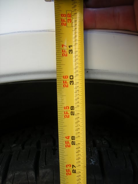

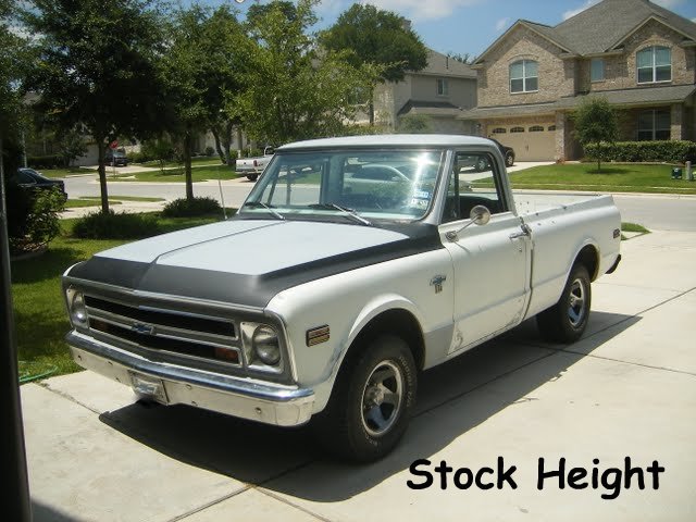

This is what I started with

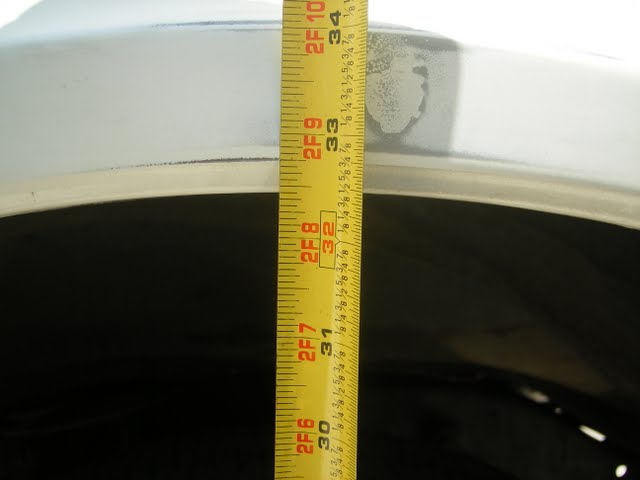

Wheel well height from the ground (32.5")

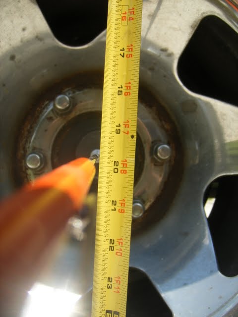

Hub to wheel well height (19.5")

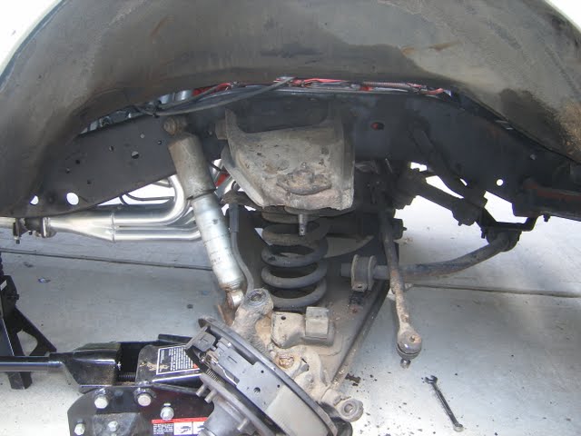

Getting it apart was pretty straight forward

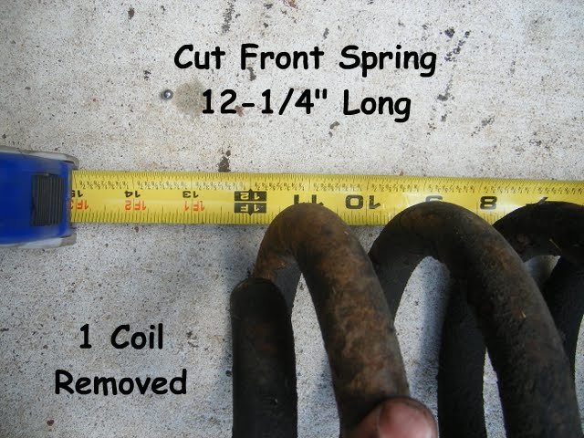

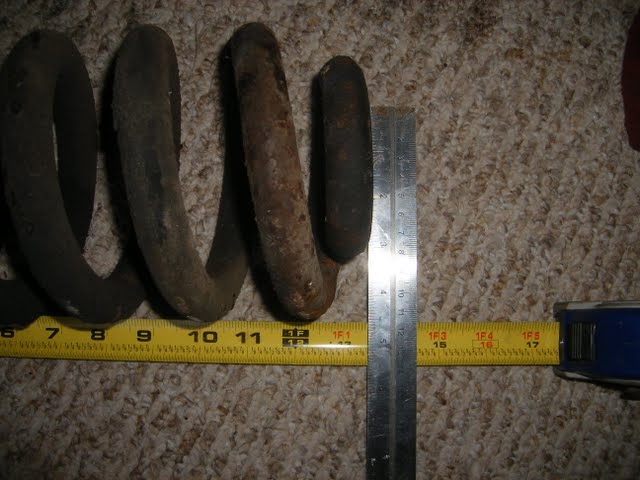

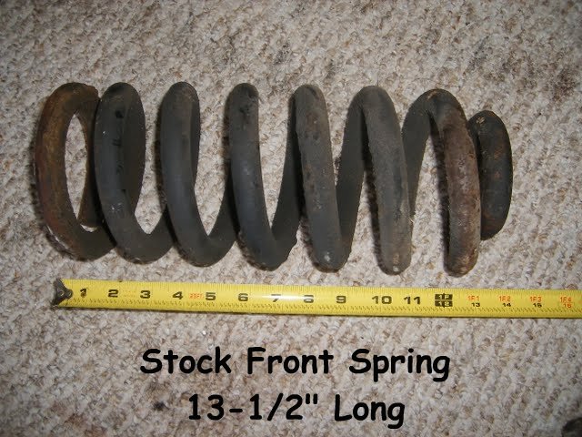

The Stock spring (13.5")

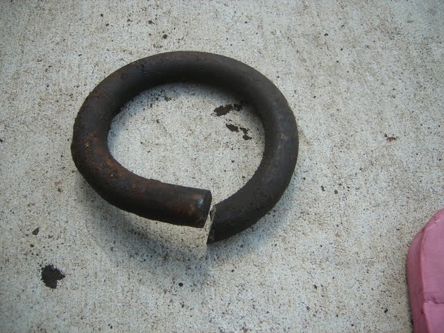

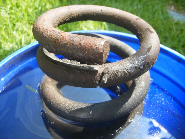

Slice & Dice Time
The aftermath... Cut spring size (12.5")
Wheel well to ground (30") Hub to wheel well (17")
As she sits now
Before drop
Wheel well to ground - 32.5"
Hub to wheel well - 19.5"
Stock Spring size - 13.5"
Tire and wheel info - P275/60R15
After Drop
