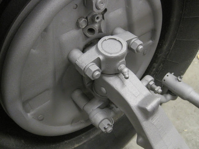

Where would I find information on detailing the suspension on these trucks? Is there anything specific, or does it even matter?

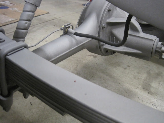

Thank you sir. I have a thread going for the entire resto ( http://67-72chevytrucks.com/vboard/s...d.php?t=420843), but just got the frame, with suspension, sandblasted. I'm gonna POR15 and topcoat the frame with semi-gloss black, but wanted to get the springs, backing plates, rear end, etc., the right colors too.

Nice blasting job but it looks like the brake line connector might have some blasting material in it, please make sure you flush your brakes properly before driving.

Ya, the industrial blasters have a lot of power, and the operator is a perfectionist for sure! I'll be going through everything you see, incl. the brakes, whihc is why I'm looking for info on detialing these parts....

Looks good man! I would make sure to replace the wheel bearings and seals. By the looks of you picture your backing plate got blasted and I'm sure it problily damaged the seal and you could have blasting media in the bearings. Seals and bearing are cheap. You might also want to check the king pin also.
