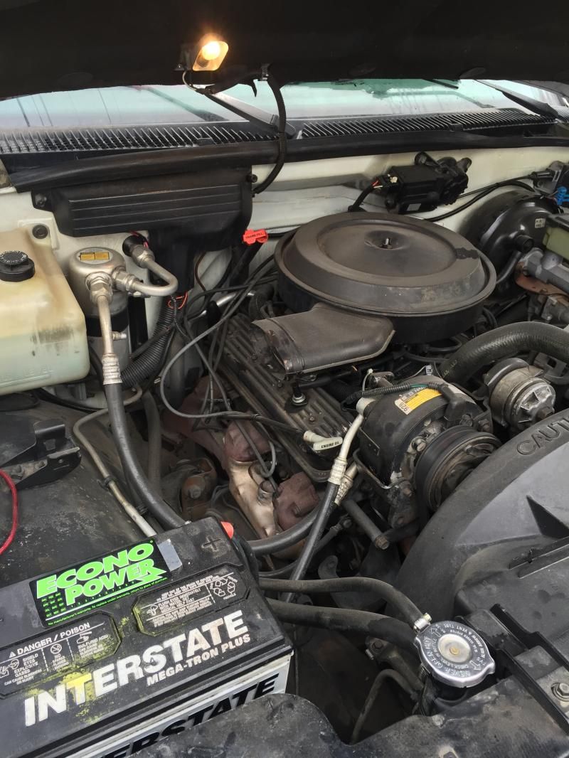

I need to find out so I can order parts these motors are identical but I googled the vin number and it came up as a 350 but who knows if a 305 was put in but here is a couple pictures

Get the casting number of the block, it's on the ledge where the tranny bolts up, driver's side. If you can't see it, use your phone to shoot a pic. Then Google that number, it will tell you. 305 and 350 blocks are different castings, they cannot be used interchangeably.

Those pics don't tell us anything except you paid $25 for your battery
