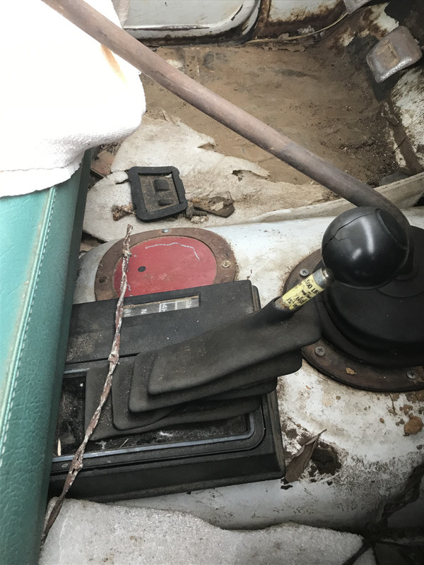

I don’t remember this kind of cover over the 4X4 lever. You think the transfer case has been changed out?

Looks like it’s been cobbed up

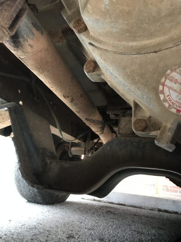

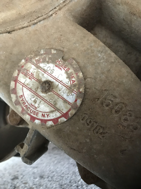

Looks like an NP208 from a square body was swapped in. It’s common for the original Rockwell cases to be swapped out in the 67-69 trucks.

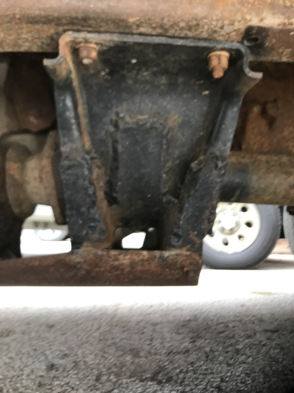

1985-up crossmember
1980's up np208 t-case and shifter .
lots of mix - n - match there for sure .

I'd call it swapped but not cobbled.
