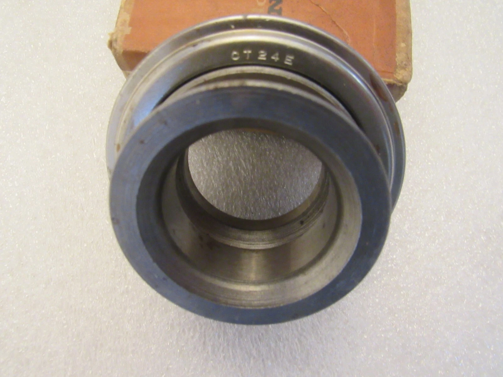

Lightbulb Re: 72 Chevy K20 SM 465 throwout bearing
Marked "CT24E" per the book:
Other part numbers include 900018, 907403 907826
