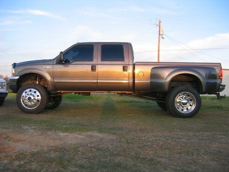

if your not gonna lower it, go with the 22.5's and a standard tire, a heavy truck tire on a dually would last longer than the truck will and would look cool too !

I don't think they'll fit with out a lift. The smallest 19.5" tire you can get is around 32" tall, and 22.5s are quite a bit bigger, as you can see.

yes, they are much taller. he has made mention of lift'n or mabey convert'n to 4X4. just try'n to push him along sence I cant talk him to lower'n it.
