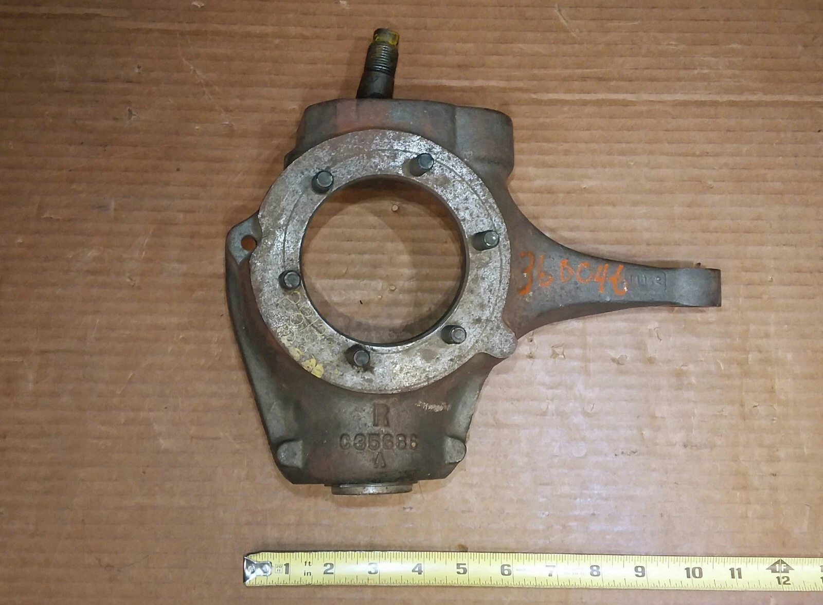

If the threaded hole in the knuckles isn't there, then I would suspect either the knuckles or front axle have been changed at some point. You could look up the axle numbers.
My dust shields were in about the same shape.
Gary
The threaded holes are there, and thankfully there aren't snapped off bolts in them, which is what I was half expecting to find.
pjmoreland is online now   Reply With Quote

Nice, so that's most likely the original front end. After 72 those holes were no longer.

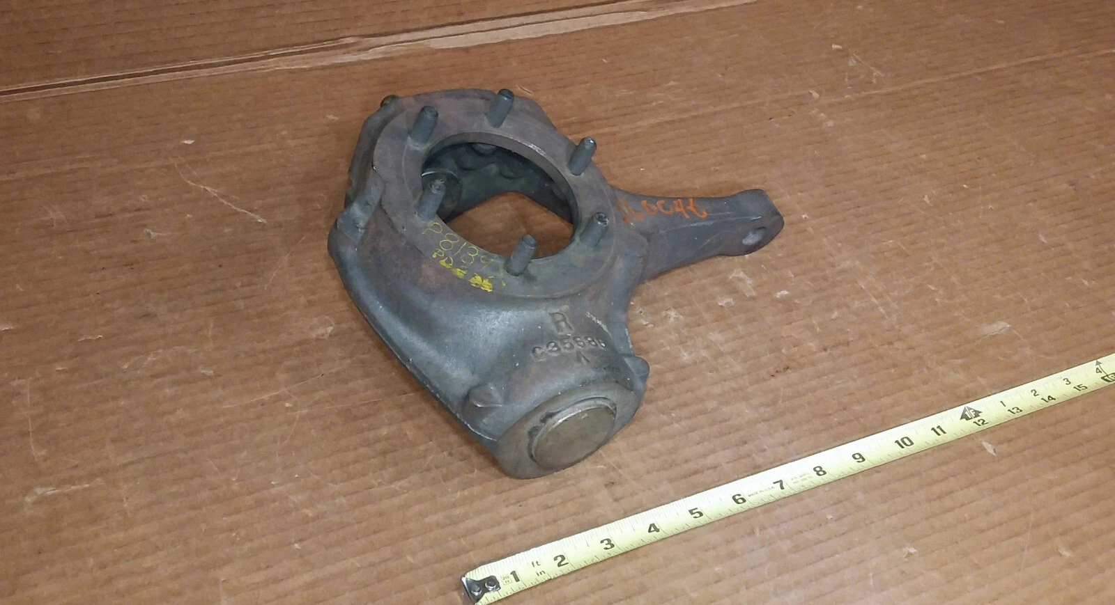

As shown on this NOS 360046 passengers side knuckle currently on everyone's favorite auction site!
This part number is used from 1971-74 in the later parts catalogs.
Looks like it would be easy to add the missing dust shield tapped hole.
