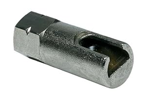

Try one of these with the U-Joint turned to the right position...
Those require a specific fitting, not the typical zerk.
I've used one on straight zerks that were difficult to reach at best. Dirty grease squirted out around the unsealed shaft away from the zerk so it was feeding through and not just making a mess at the zerk. It wasn't a super tight seal though.
I'd be interested to see the fitting they were actually made for. If it's low enough profile it might be worth changing to... in places like the upper Ball Joint on the Dana44 and down those nasty holes on the baler and the chopper... If I can reach em to swap em out.

okay, today I tried this fitting. got it from Amazon for great deal.
I thin I had it hooked up, but still no grease went into the zerk fitting I think.
man, this greae point is giving me a head-ache.

so happy.....tried the Thexton grease coupler again today and I guess I never had it put on correctly before.
I used a plier to put it on and then connected the grease gun...et voila! suc6...upper balljoints are greased now.
just wanted to give heads up over here on my succes.
this is the link to the tool:
Thexton THE418 Grease Coupler
Thexton THE418 Grease Coupler : Amazon.com :... Thexton THE418 Grease Coupler : Amazon.com :...
